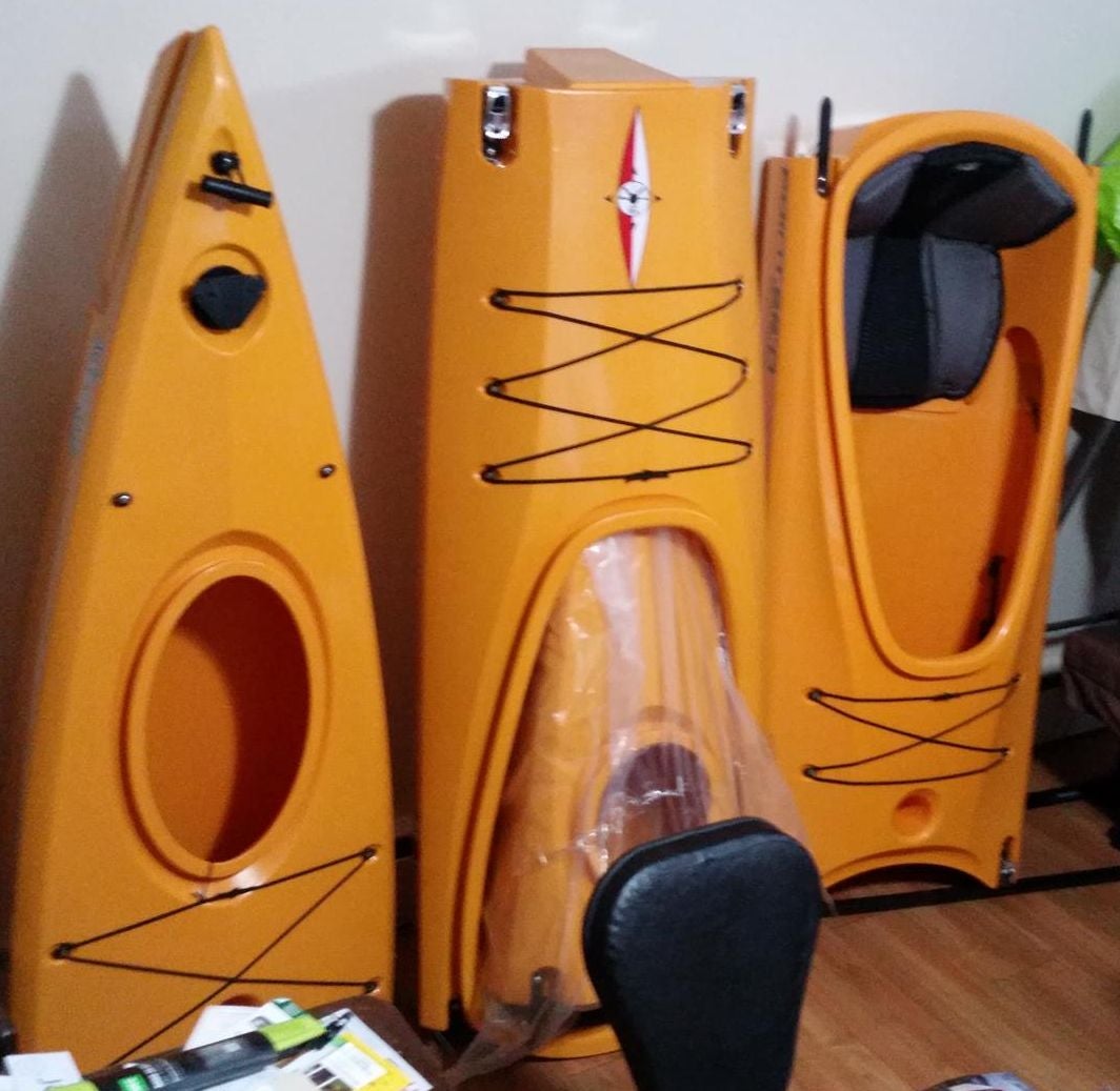

If you got one of these kayaks, might not need roof rack.
img_20190713_155743-jpg.32226
I've never seen a kayak like that before.

I also have a point65 three-section sit-on... I can get all 3 inside the Prius; I have
yet to try the Kona but I expect at least the two ends for single-person mode will fit.

As neat as those kayaks are I already own two kayaks so not really thinking about replacing. Would like to try one out to see how they compare performance-wise to a traditional kayak.

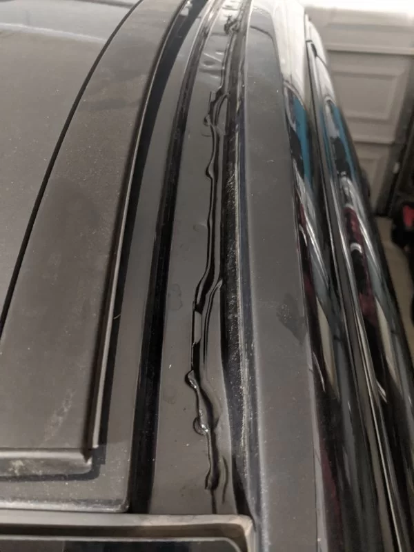

I tried ordering the rails from the dealer and they found out they wont fit. they are also right about adding this to our US version KonaEV, it will involve at the minimum, welding or drilling. This is what it looks like under when the rain gutter is removed. It just have a few metal tabs that holds the plastic trimmings. the roof rails from ICE version Kona has screw holes which will need to be welded at the precise spot. the screw tabs from an OEM Sonata might seem to work, but still needs to be welded. the OEM rails looks cleaner than the Rack attack version. seems scary to me to have holes drilled on my car.

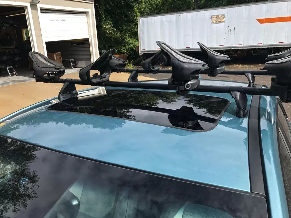

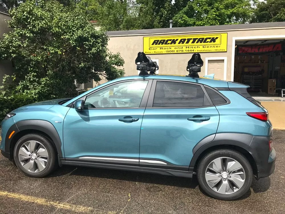

So I finally got my kayak rack on the Kona. While I considered the Yakima base clips I already owned a pair of cross-bars with landing pad mounts so all I needed to order was the landing pad strips. This did require the installer to drill holes in the roof of my car. I cannot tell you how awful I felt as I watched him drill but these guys did a wonderful job, very professional. Here are some pics of the finished work.
You can see in the close up on the last photo that the actual landing pads are inside the gutters. I don't necessarily like it from an aesthetic point of view but it's not terrible. On the plus side these bars pop off relatively easily leaving just the base strip so when I'm not hauling kayaks my efficiency won't be harmed.

Hey, that's great. good thing you already had bars and landing pads. I certainly appreciate the anxiety of drilling holes! but I guess that's what the pro's are for. have a great weekend!
They did do a nice job, looks awesome as well as provide some effective advertising for the installation shop in the first 2 photos;)

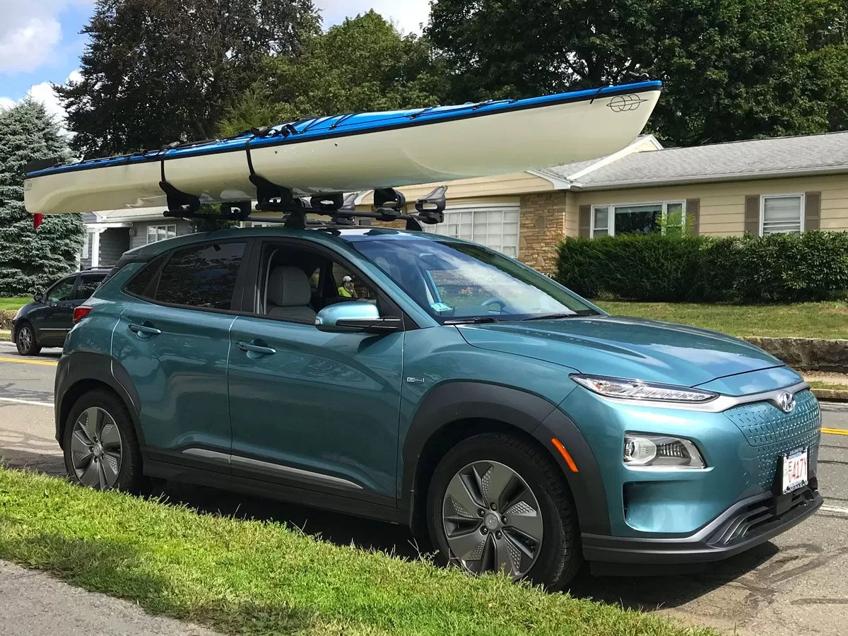

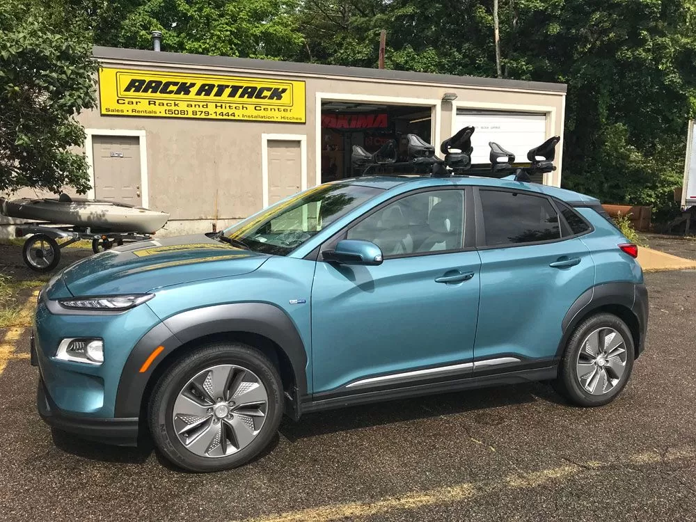

Here are a few more pics. One with the kayak on top of the car and then showing what it looks like with the racks removed, plus a close-up. This is turning out to be a great solution because the crossbars literally pop right off when you want to remove them. Two, maybe three minutes if you are extremely cautious.
The landing pads have nice covers over so the latching point isn't exposed for a neat and tidy look.
