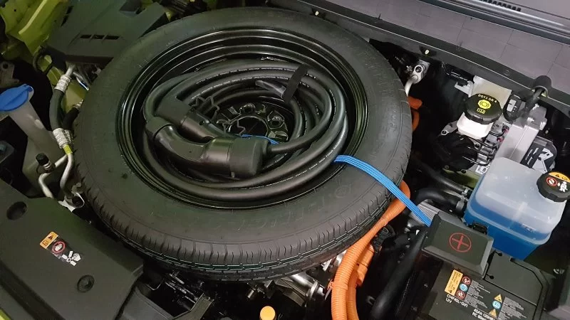

Has anyone else tried to put a spare tire under the hood?
Just to confirm.... that’s the Azure donut as per your earlier link?
Sent from my iPhone using Tapatalk Pro
Yes the 17 inch Hyundai Azera compact spare

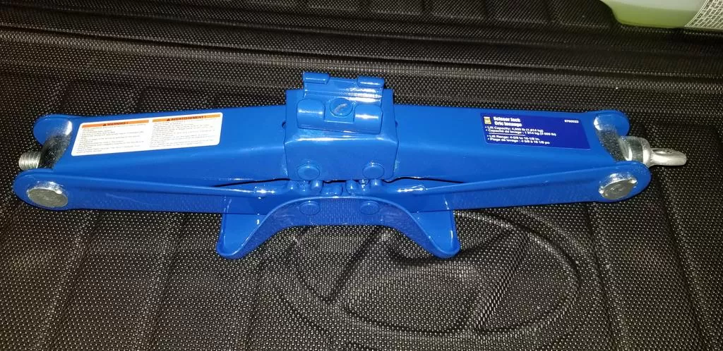

What kind of jack are you using? Fit under the donut?
Just a generic 4000lbs(way overrated) scissor jack I got from Princess auto(Canadian equivalent of Harbor Freight) for $15. I have it under the donut, as the donut sits a bit elevated because of its size ,it supports the wheel and its lay relatively flat.
I can confirm the wheel fits and clears the rear calipers without rubbing. If it fits the rears it will fit the fronts as the hardware is less obtrusive without the ebrake mechanicals. Got rid of the foam carrier with, compressor/ fix a flat kit, now have the compact spare, jack, tire iron, gloves and some duct tape(always handy).

Yes with the donut you loose that space for the 2-3 inch second tier foam tray(which interestingly no longer comes with the 2020 models) and I have to relocate the granny cable box somewhere. Perhaps in the frunk. I agree for mostly urban travels the fix a flat or getting towed by road side service might be the easiest solution. I am frequently in the middle of rural nowhere so for me this is the more logical option.

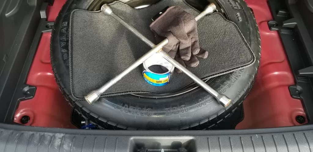

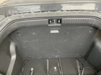

Hi, are you still able to place the luggage board at its correct horizontal position with that spare tyre below it? I suppose the upper foam tray has to be removed?
Yes the luggage board fits correctly but you will have to remove the upper foam tray.

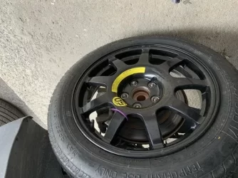

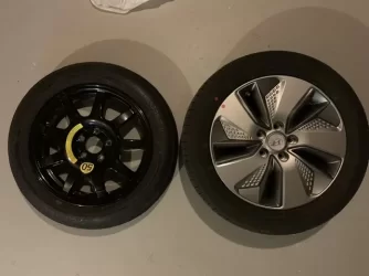

Following Apu’s info, I bought a Hyundai Genesis 17” spare tire on EBay for 90USD (120CAD).
it appears to be a perfect match size wise. I haven’t done a fit test but I’ll try once I switch to summer tires (soon hopefully).
135/90/D17
135/90/D17
Looks great! Please let us know if it clears the larger (rear I believe) calipers. Thanks

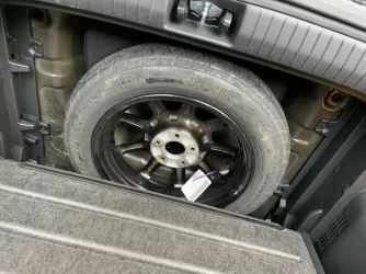

To follow-up, I changed my tires and tested the spare on the rears. It fit well with plenty of space.
Again these were the 17” genesis spare tire from 09-14.

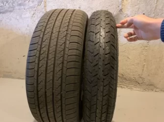

Argghhhh, I had a flat tire just this week. It was a puncture right in the center of the front driver side tire. I used the tire mobility kit, and thank God it worked! and I was able to get home (I was 50 miles away....so towing would not work).
I am looking into having a spare tire just incase. I did some research. I think I like APU's solution the best, because it seems to fit under the trunk w/o sacrificing the actual trunk space. However, I looked at the Kona EV kit from Modern Spare as well. I really liked how their tire allows you to travel at highways speeds (up to 81 MPH)....but the problem is that spare is 18 inches, not 17 inches.
After replacing my slimed-repaired tire at American Tire Depot with a new Michelin (they have a great deal of buy 3 tires, get 1 free deal), I tried putting in that regular Nexen tire in the trunk.....to my surprise, IT DOES NOT FIT. You have to fold down the rear seats to be able to close the trunk. I am imagining if that 17 inch Nexen cannot even fit into the trunk, how would Modern Spare's 18 inch can? True that Modern Spare's tire is thinner, but its diameter will probably exceed the maximum 27.5 inch length of the Kona's trunk space (without folding down the rear seats).
I will email Modern Spare as to whether their kit can actually fit into the Kona's trunk. Any insight, guys???
