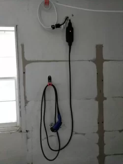

I use a garden hose hanger along with HD extension cord that connects to the portable EVSE. The control box sits on the coiled cord, the garden house hanger is securely mounted to the wall and is able to support the weight no problem. My motto:KISS.
I just used a plastic hose hanger. It had a little shelf that the charger fit on and I just put some zip ties around it to hold it. I had it this way for about 6 months before getting a proper level 2 charger.

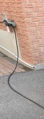

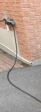

Here's my setup. Carport is EXTREMELY narrow and in winter the floor will be covered with salt water and snow. The control box is gentley screwed in to the wall and the cords are hung with regular garage door utility hooks from home depot. The extension cord is century wire and cable 12ga.

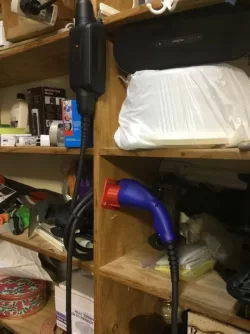

Here’s my simple setup. (Excuse the messy garage.) The controller box is attached to the rack and I 3-D printed the red holder for the plug. A similar plug holder is available for purchase on Amazon.

Looks like you have it plugged into a Kill-a-watt or similar device. I've read stories of those devices melting down because they are not built for continuous duty high amperage.
Yes, it is a Kill-a-watt device that I am plugged into. I have been using it continually since February to record usage. So far it has been barely warm in continuous (<12 hour) use.
