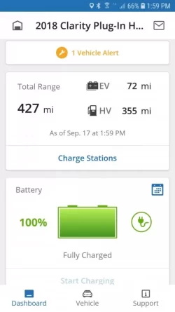

I've been meaning to post the same for some time. Even without the skilled driver component, I think having the default regen closer to a coast would up range across the board. Use it when you need it, but otherwise all regen does is slow you down. When I practiced coasting is when I pushed my ev miles up over 70.
