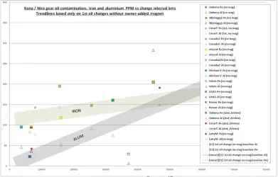

From the forum it is pretty clear that changing the gearbox oil after break-in is a good idea. I've had this done after 5k km at the dealer - C$100 for the oil and C$150 labour! Has anyone had the black oil analyzed to determine why it's black? Will the new oil also turn black after some time (I hope not)?
Locally a Kona owner was quoted NZ$446 for the pleasure, a blantant ripoff. Others pay NZ$130 upwards, many at around 200. In the US the only report I have is US$140, in SoCal.
I'll note that the oil called out in the owner's manual of either EV is Hyundai/Kia DCT 70W GL-4 which the SDS describes as "clear brown". It doesn't say anywhere to throw in a pinch of iron and aluminium filings, which is what 99.9% of all these cars are running right now. So, yes, changing the oil at least once is a really good idea to reduce the risk of unnecessary gearbox noise, be it a warrantable repair or not, never mind the admittedly-rare chance of a complete failure.
The gearbox is not a cement mixer, it's a precision machine and needs pristine oil as stated. Compounding this problem is that there is considerable evidence that the internal magnet that MOBIS/Transgear install for the sole purpose of sequestering newly-released steel wear particles is not very effective. Many of us in Kona-land install either a magnetic plug or add a few magnets to the outside of the OEM plug, and by the two UOA reports so far, that's working. See the text in my video below.
Eleven Kona/Niro owners so far have paid for used oil analysis reports which I add to a graph for comparison as they roll in. Most first-time reports indicate the levels are "very high" for the kms/miles driven. And why is the oil black? That's been a quandary for me but I think it's mostly or only the aluminium contamination, the source of that being unproven so far.
Great work and clear reply. Thanks for this. Interesting that the concentration of contaminants increases with time/distance driven - maybe suggests that this oil should be changed regularly. What do you think?
The trendlines are more to indicate the data averages for comparison purposes rather than to imply that the levels increase linearly with distance driven, which they are unlikely to do. The data is far more widely scattered than I would have expected a year ago, which is puzzling given that every gearbox should be nearly identical. The number should ideally all be where JohnL's numbers are (near the 40,000 label), low, as we would see from a Nissan Leaf which has a similar gearbox design.
The aluminium contamination is not a direct threat to gearbox health but the fact that the source is unknown is troubling. There are no normally-wearing aluminium parts in this gearbox. The material must be coming off the housing, but where and why is the question.

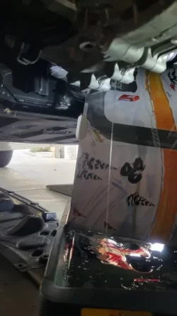

Got it done, 10mm for the 6 bolts for the engine splash guard. 24mm for the two drain plugs. Oil at 9700 miles didn't look too dark.
