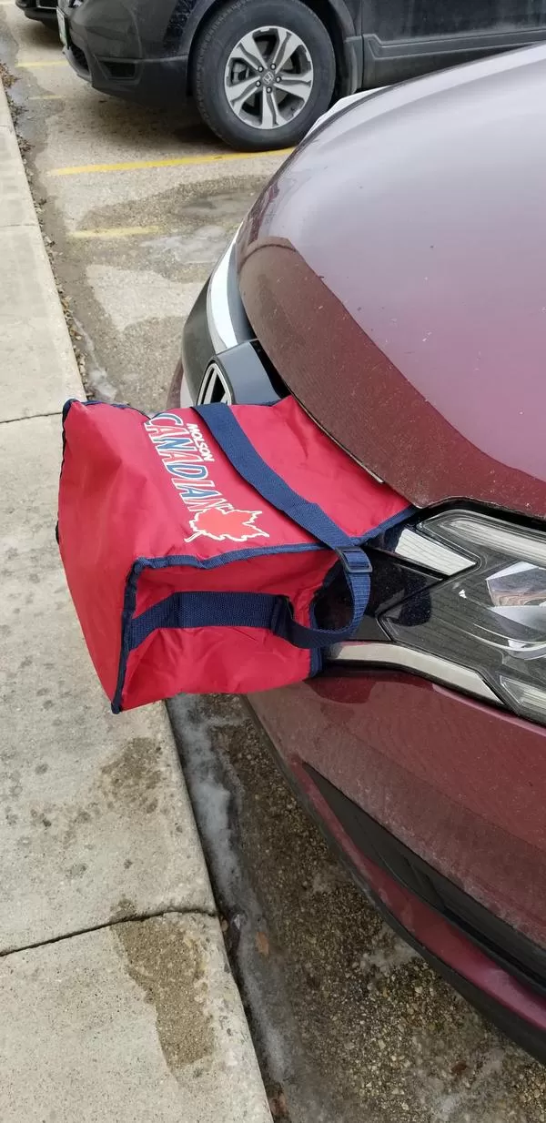

Ok, the cooler ended up costing only a $1 from the thrift store and I have yet to put in a precision cut for the J1772 plug to pass through but I think this is proof of concept :)
Hope no one steals your thrift store find. Maybe the coal rollers will appreciate any alcohol logo cooler bags;) It's kind of stupid for a >$35K ride to have to add a hill billy hack to protect their fuel port?

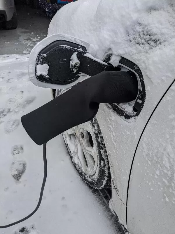

Found this more cosmetic solution on the Clarity forum:
I assume the protective cap can still be inserted into the door holding slot while charging, thus avoiding becoming a " charging dangler". :eek:

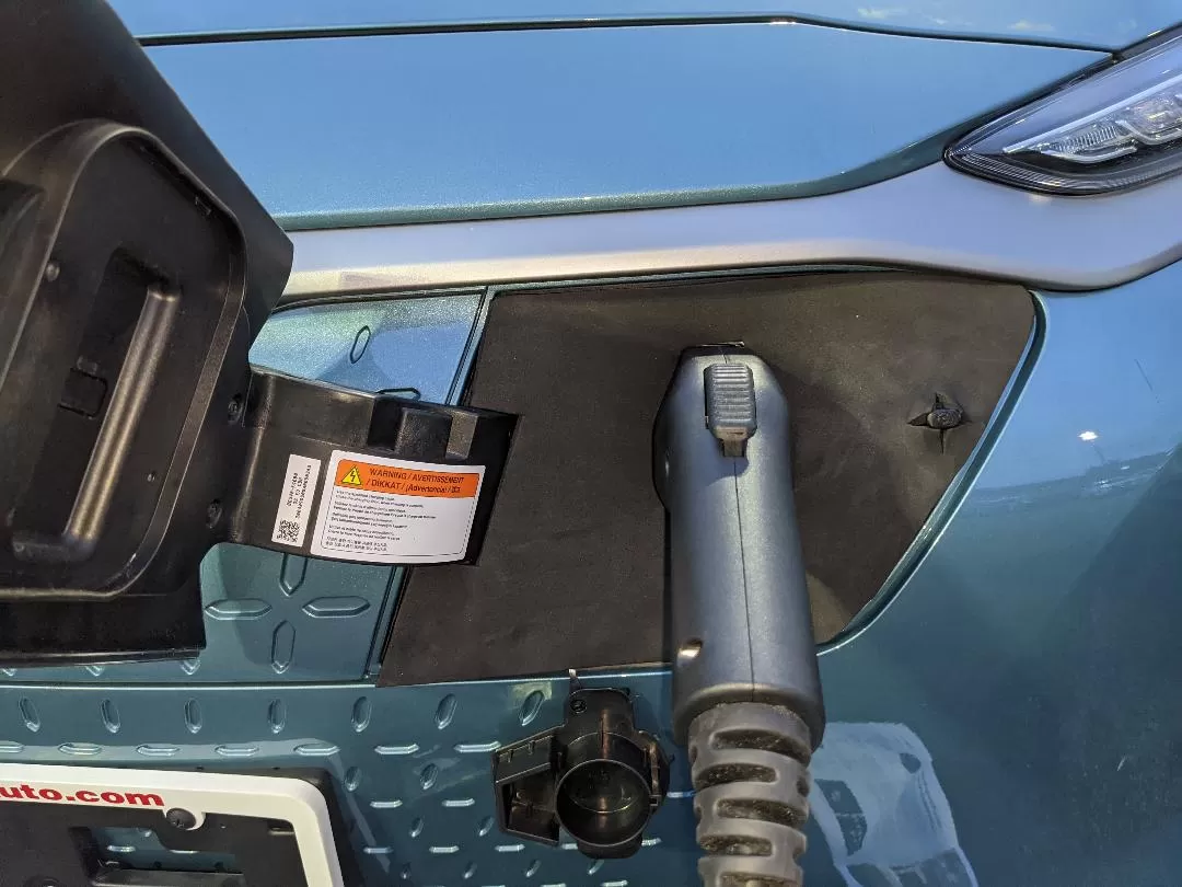

Add the "ChargeSleeve" for additional protection:
Link:
https://voltshelf.weebly.com/kia-niro-and-hyundai-kona.html

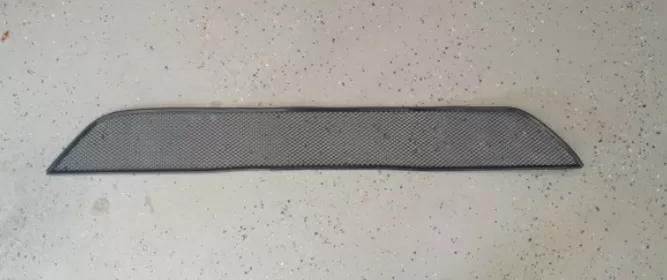

I also like the "Voltscreen" idea for the lower front grill which is wide open and very susceptible to rock or debris damage and may save a future radiator costly repair:

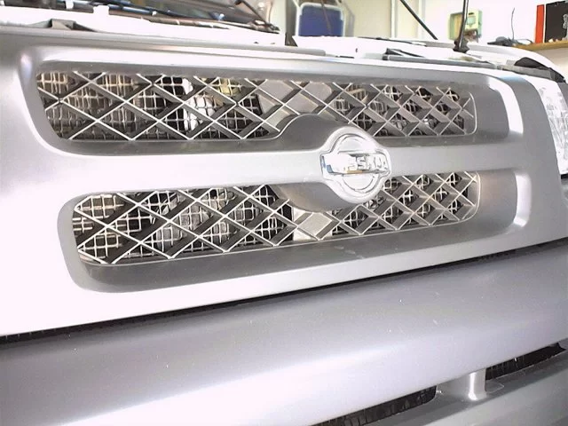

I've installed a coarse mesh behind the grill on every car I've owned over the last 20 years, with exception of the Kona which has the shutters and a BMW which already had one. I think it helps keep the condenser clear of larger bugs and pebbles. I would use at least 1 cm pitch though to avoid affecting the airflow too much in warm climates. This sort of mesh is normally sold to fit across rain gutters to keep leaves out.
I am thinking given the radar sensor location, a plastic or nylon type mesh would be better to avoid any interference, obviously cut in a way so it doesn't interfere with the area in front of it.
BTW I have noticed the shutters closing only on intermittent occasions in the summer so I would not depend on those entirely .
