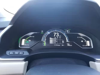

Just did a 1000 mile road trip from Miami to Savannah,GA. Mostly in Hybrid mode on i95. MPG in pure HV mode is about 46-47 when speed is around 70mph, When speed is 75mph MPG is around 45.5-46, when speed go near 80mph I see the MPG drops below 40 on the range estimate screen.
The EV range doesn't drop down when in HV traveling long distance. If I started the drive with 40mile EV range at end of 300 mile trip I would still have about 40 mile EV range left so no HV does not consume EV battery that much, or it recharges it back to about same level.
Super fuel efficient Hybrid I must say.
Attachment shows last 4 trips.
This is why I don't feel guilty pushing the HV button when I am established on the highway. I dislike driving in HV in the city, but feel that the car performs fine on the road as a hybrid.
