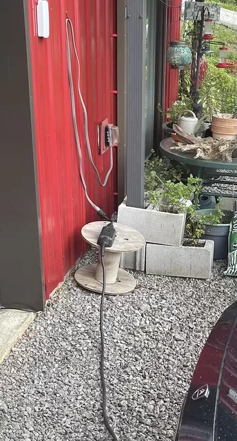

Thank you very much for the information enirogus and Northof49! I was hoping to run the extension cord close enough to the front of the house so that I can just plug in the portable level 1 charger nearby the car, which I think is roughly 20 feet. There's a bunch of plants and stuff in the way of that outlet, so was hoping to hang the cable under the roof, that way wouldn't have to go through all the plants each time to connect. But yeah I'm also afraid that if it use the wrong extension cord it might over heat.
Thank you again for your help.
This is my 120v outside setup:
The outlet is otherwise kinda hard to reach.
As long as the extension cord is well made and of sufficient capacity, no reason not to use one.
Thats a long cord. Although rated for the amperage a level1 charger draws I would bet a pack of donuts it will heat up over a long period of time. There is the issue that I've read of where some charger computers are able to sense when an extension cord is used. I'm not sure how but if it were me I'd stick to 25 feet if possible and move to 10/3 which is rated for 30 amps. I'd borrow one if possible to make sure there are not any issues. I've used a 100ft 12/3 with a chop saw during house building and it gets warm after a few hours of heavy cutting.
