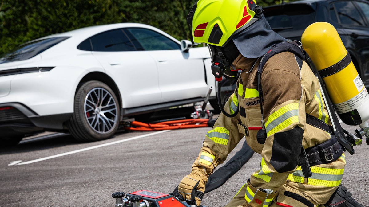

Innovative remotely operated equipment developed in Austria specific to EVs will now reduce hazards related to Lithium Ion EV fires and will be available for fire departments to receive delivery by early 2022. The unit has been tested with all cell formats including pouch, prismatic and cylindrical cells.Yes, most EV and PHEV's manufactures have had fires including Tesla, Hyundai, BMW, Chevrolet, Dodge, Nissan, VW, Porsche and the list goes on. Here is a link to Wikipedia on the topic of EV fires.
