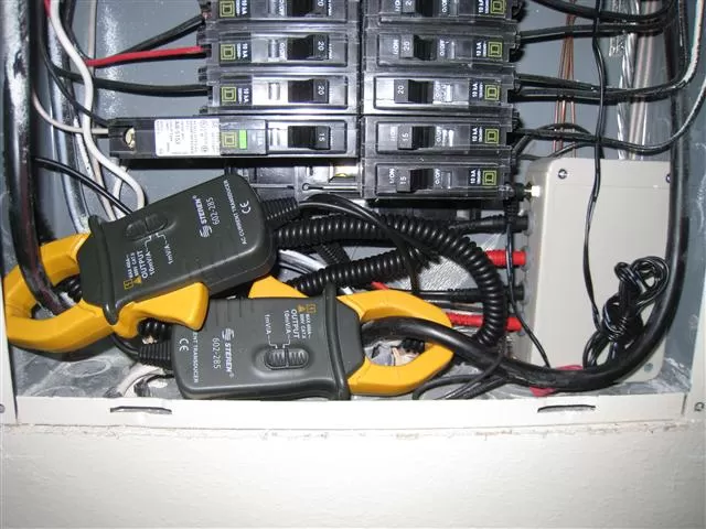

I had an electrician visit today for estimating. He suggested 60amps, even with my house having a max of 100amps service.
This leads me to a fundamental lack of understanding of how this works. Let's say, for instance, that I get a 60amp circuit, and overnight, the washing machine and dryer are running when the car kicks in to recharge, and, for good measure, the boiler pumps kick in as the house pre-heats for the day. Let's also say the fridge kicks in for a moment, the desktop computer is running (always does) and the usual trickle charge of every device, as well as phones recharging etc.
What happens if this draw exceeds 100amps? Does the main circuit flip and protect the house? Or does something explode?
More importantly, how can I measure the maximum draw of the house today?
The 100 amp circuit breaker *should* just trip and disable if you exceed it. The best way to measure the maximum draw is to figure out what time of day most of the biggest power draws are turned on. Where I live, it's during a hot summer day when the air conditioning kicks in. Then you can write down the meter number, wait an hour, then check and see the difference. That will give you a good *average* of your peak. It's possible you may have immediate load spikes; those can happen for brief periods, like when your appliances turn on/off. The only way I know to measure those is to get a device like a Kill-A-Watt and plug your device into it. That will give you can instantaneous reading, but it only works for appliances that run on 120V and that you can plug directly into the device.
Over time I've recorded what the maximum draw is for nearly all of the devices in my house; the ones I pay most attention to are the ones with very large motors or compressors, and heating elements. So that means I worry about the air conditioning, electric ovens, clothes washers/dryers, toaster ovens and hair dryers and portable space heaters. The next step down are things like computers, treadmill, TVs. There are high-draw devices that are *very* short in duration like blenders, vacuum cleaners.
I have a 200A breaker and I don't think I've ever come close to exceeding even 100A, so your electrician *might* have a point. But the other thing to consider is what he's good at - he may be steering you towards a bigger circuit because that's what he's good at installing, whereas someone who is good at doing panel replacements and pulling permits would advocate for a 200A panel.
I'd get yet another opinion, but it appears you've already done that and it's just adding to the confusion. :(
If you're going to just have the MINI SE, a 40 A circuit is fine since it won't draw more than 7.4 kW (31 A) (draw has to be under 80% of circuit max). That should be okay on your existing 100 A service. When I did my install I had the wiring put in for a 60 A circuit (heavier gauge) but with a 40 A circuit breaker, since replacing the circuit breaker is relatively easy compared to replacing the wiring if I need more power for future vehicles.
If you add a second EV down the road that would be the time to consider what it would cost to add another 100 A service to your home.
As for measuring load, at one point I thought of a DIY project like the Not So Tiny Power Meter, but I don't have the courage to take the cover off my circuit panel to add the clamps.
