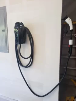

We started with (and currently own) a Tesla Model 3, so I've got a 60A breaker to charge it at 48A with a Tesla HPWC (high powered wall connector). It's hardwired and very sturdy, with a 24', heavy gauge cord.
When my SE comes to join it, I plan to use the Tesla connector with one of these to adapt it to J1772:
https://www.evseadapters.com/products/tesla-to-j1772-adapter/?variant=36339297937

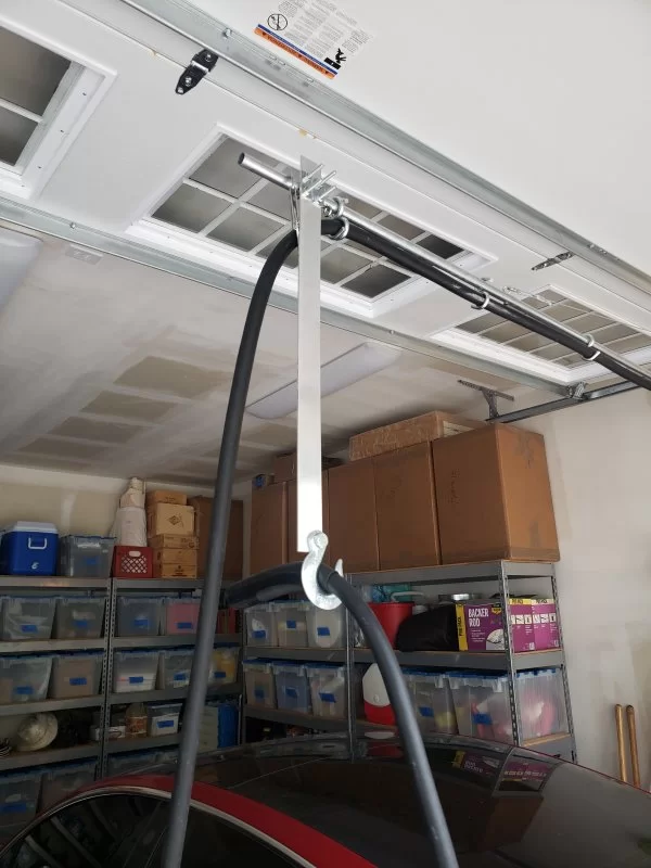

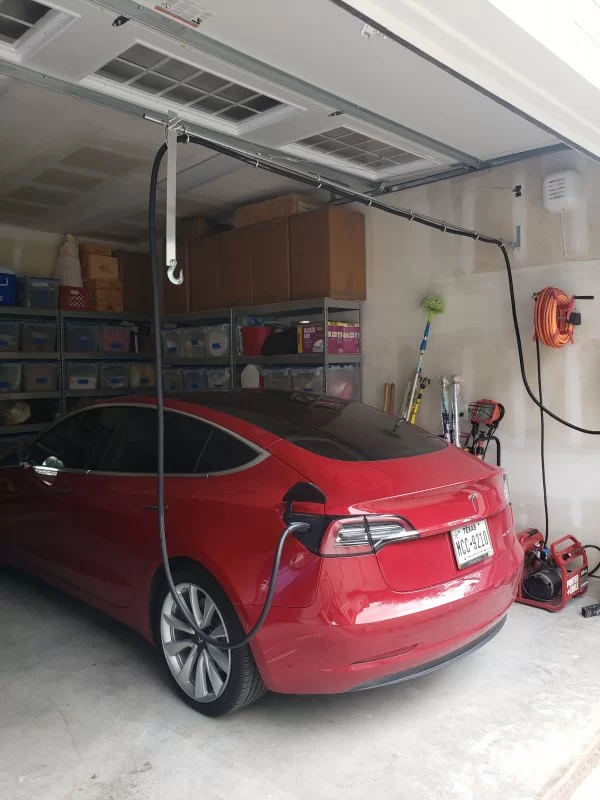

Recently, I built an arm to hang the cable in the middle of our garage. With the Tesla's charging slot at the port aft and the Mini's starboard aft, we'll both be able to nose into the garage and trade using the same charger.
View attachment 8769 View attachment 8770
Well, all this time waiting for SE delivery and I said "screw it" and just installed a second Tesla HPWC, with an adapter to convert the Tesla nozzle to a J1772.
With this setup (both Generation 2 HPWCs, wired in parallel on my 60 amp breaker and connected with a communication cable), the units will share the 48 amps, with the Tesla nominally drawing all 48 and the SE pulling 32 when each is charging 20200729_093021.webp by itself.
I did this so my wife and I could each plug in whenever we wanted without having to think about the other's charging intentions. Mostly, we will just plug in when we arrive home and then let the timers start things after midnight. With my electric company, I pay about 1.1 cents per kWh between 0000 and 0600.
Also, I like to back in, and she likes to nose in.

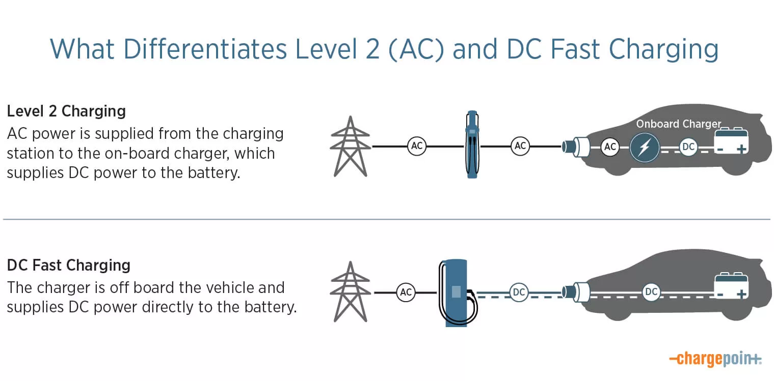

I find Chargepoint's explanation image a good way to visualize the process.
