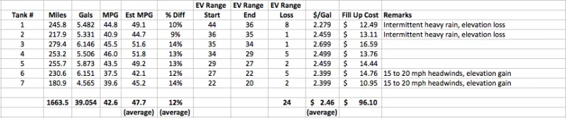

In my Florida Trip Report we only lost 24 EV range miles in over 1,600 miles of HV driving.
If your Clarity is dropping substantially more quickly than that, I might suspect something is wrong.
