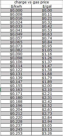

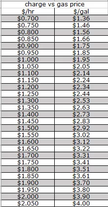

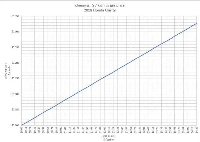

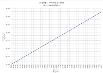

To compare electric costs to gasoline costs: assuming 42MPG on gas, 110 MPGe (1 gallon of gas = 33.7kw thus Clarity rated at 3.26MPKWH) on electric. 1. Calculate the cost per mile on gas (($/gal)/(mpg)). 2. Calculate the cost per mile on electric (($/kwh)/(miles/kwh)). 3. Where the cost per mile (on gas and electric) are equal: compare the cost per gallon to cost per kwh. For example: if electric rates are $0.065/kwh the cost per mile ($0.02) would be the same as if gasoline was $0.84/gallon.
Attached below:
A. Plot, the blue line represents where the costs per mile are equal for gas and electric costs (see assumptions above).
B. Table of the plot (A). On each row the costs are equal per mile.
C. Table of cost per hour of charging vs gasoline costs. Assumes 6.6kw. This is just ($/kwh) times 6.6kw to get $/hr. This calculation likely much less accurate than A or B above; highly dependent on SOC, battery temps, etc. Quick thumb rule: if gasoline per gallon costs less than double the price per hour of charging: gasoline is cheaper per mile. Example: if a charging station costs $1.80/hour, gasoline is cheaper per mile if it costs less than $3.60/gallon.
Again, this is based on EPA 42MPG, 110MPGe, 6.6kw charger. The per mile costs could be adjusted with real world data. If the EPA MPGe is a measurement of KWH from outlet, then the blue line is probably close. However, if the EPA MPGe rating is measured KWH at the battery then the blue line on plot A likely needs to move up about 5-10% due to losses betwixt electric meter and battery.
