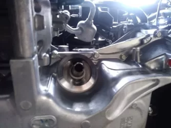

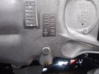

In case this wasn't already posted, 17mm socket needed for oil drain bolt.
Oil Filter Mount faces forward and drain faces backward.
Both near centerline of oil pan.
Metal cover needs to removed to see oil pan.
Unless that second picture is deceptive, that's the most room I've had around the filter in five Hondas!
