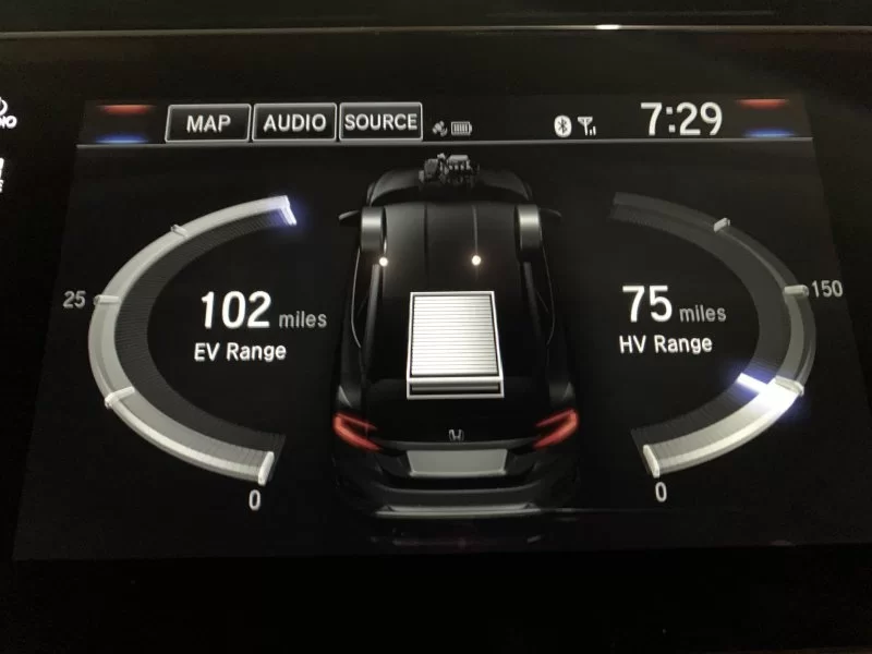

I had 98 miles range (0 electric) and ran my car in my driveway on HV charge mode for 1 hour. When I came back it was showing only 82 mile range (15 ev and 37 hv).
You would have easily gone 102 miles on that charge, if not more, had you continued descending...
