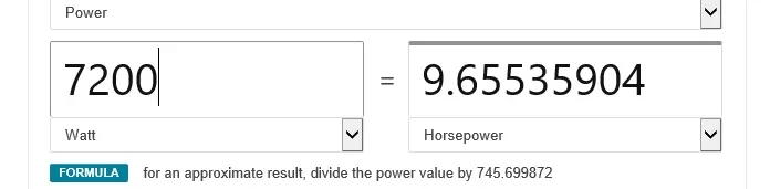

I also realize that generators can be only 30% efficient. But 7.2kw is only 10 hp, so it doesn't seem like that much from a hp standpoint. My 10hp is from attached screenshot.

Makes sense. And if your 30% efficient number is correct, it means you need nearly 35hp out of the gasoline engine to produce that 7200 watts. I can see this being in line. Clarity's 1.5 L engine likely is producing 35 hp when running somewhere in the 2,500 rpm range...
