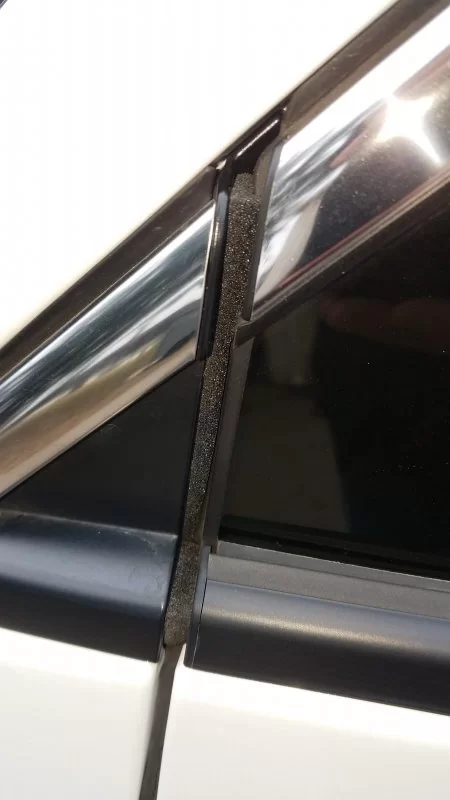

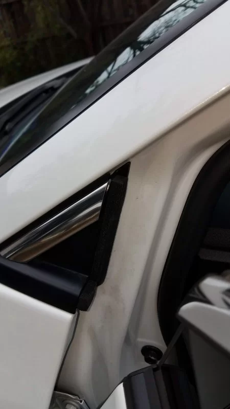

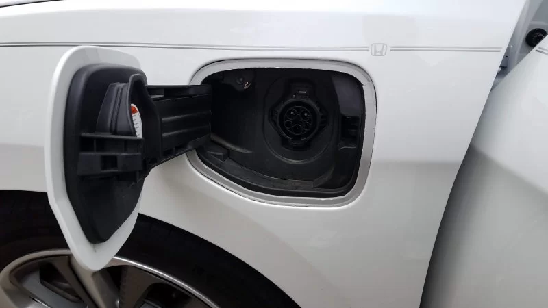

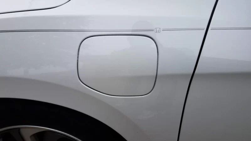

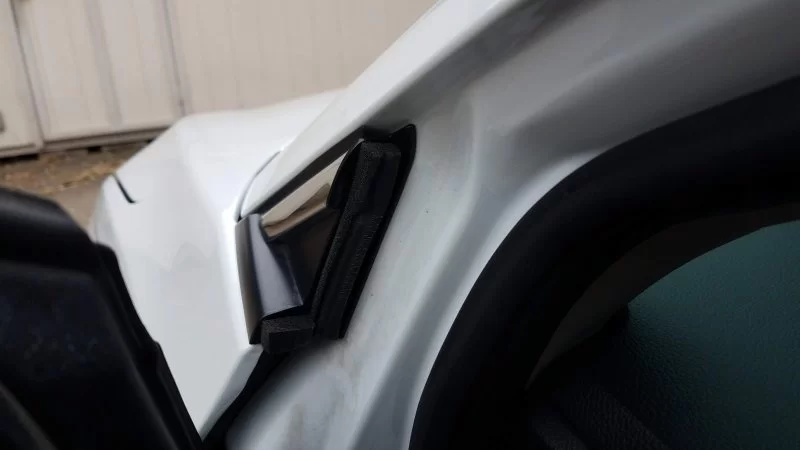

This has been an issue in my vehicle as well since I bought it. However, I do not believe in my case, it is the triangle window seal that has been reported by others (mine seems sealed correctly). The wind noise, seems to me, to be "airflow disturbance" around the area of the side view mirror. Now, since we have two of those that either means that I hear it because I am close to the driver's side (I am almost never a passenger in my Clarity), or the wind noise is coming from another source. Or possibly that I am driving to fast, nah… I have never driven another vehicle that had a "hatch" right in front of the driver's side door. The charge port is new to me as far as cars go, and I noticed that it has a fair size gap around it, and that may cause boundary layer air turbulence to rumble in the cavity. Since when I push the "open" button from inside the car the mechanism is fairly distinct (not dampened or muffled) it got me to thinking, any wind noise in that area may be more audible in the cabin (driver's side) than one would guess. Also, there is a decent gap right in front of the triangle window for air to also cause turbulence and boundary noise. This gap is environmentally sealed (water intrusion) by a small grommet extrusion in the shape of a blade that contacts this gap. However, it is evident it was an afterthought for water and would do little for “noise.”

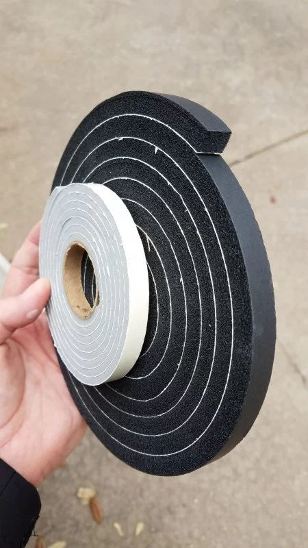

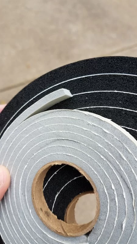

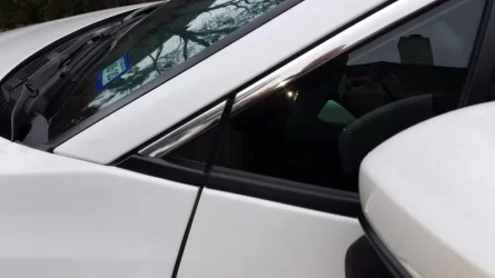

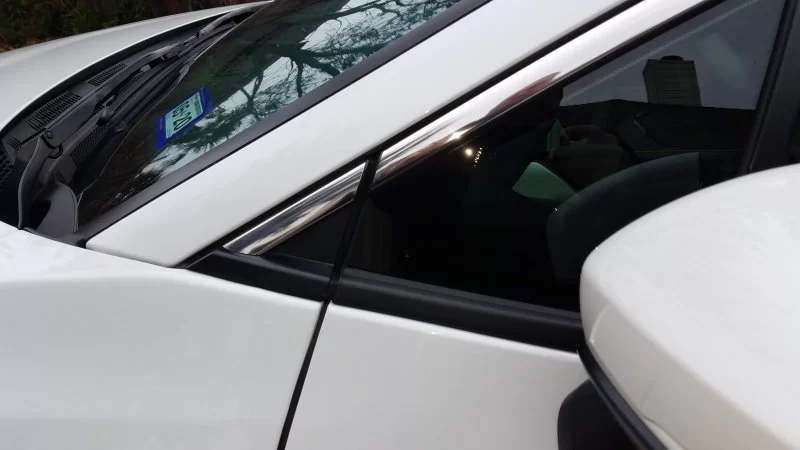

My solution was to put cheap big box window foam gasket seal in. This is not glued in yet, as I am testing it, but I have to admit that the car is noticeably quieter and there is far less wind noise now. As to appearance, well – they all pass the 3 foot rule easily and in fact are very difficult to see unless you know what you are looking for (photos attached). Took 5 minutes and $5. You be the judge. I might have preferred black seal for the charge door, however the part of the seal that is visible actually matches the pin striping the dealer applied. If you are wondering, the seal does not impact opening the charge door, although increases the close force just slightly. I do not expect it to be any source of concern and may keep the rain (or car wash spray) out of the cavity. Again, just presented as an FYI with YMMV.
Gasket foam was on hand, also didn't have the bag they came in but measurements were: large black was .5x.3 inches, and small grey was .3x.15 inches.
What a coincidence that you posted this today. The wind noise has been bothering me, too, but I wholeheartedly expect the dealership to give me the runaround and waste my time. My Clarity has less than 500 miles on it. I'm going to try the foam seal. Thanks for the advice! Please reply back with updates it you can!
If you have not followed my other posts you may not know that currently (and I am actually working on this today) my ANC (active noise cancelling) system is disabled in my vehicle, as a result of a car audio system upgrade. Not an issue normally, as I have my stereo on at a moderate volume masking any cabin noise entirely. However on the rare occasion that I have the stereo off, my vehicle may be more "cabin noise prone" than most. I plan to reduce the road noise (tire noise) substantially when I finally replace the high efficiency tires with good quiet touring models. However, this ANC situation may be why I am more acutely aware of these little noise sources (and my apparent OCD/ADHD in this arena). What I will report is that today it is quite windy in Dallas, and I had to make an airport run on the tollway with the stereo off at the request of the in-laws that were passengers. The tollway is 70 mph , with traffic cruising at 80+ and a good gusty wind. I can affirmatively say that this little foam seal mod has made a subjective difference (reduction) in the noise I would attribute to "wind" passing around the car as evident from the driver's side. I have no regrets and will leave the mod in place for as long as I own the vehicle.
