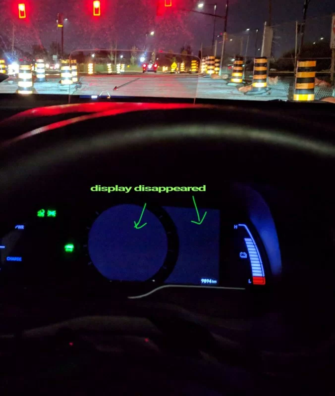

I don't think this is a duplicate. My speedometer , and vehicle information display went dark. Yet things like the SOC , regeneration meter, indicator, Auto.high beam, light was visible.
This is a new one, when my screen went blank it at least displayed open door. Check 12V battery voltage (just to eliminate 12.6 V min)

The night it happened. I drove in circles in a dead end street after restarting twice. It didn't reappear. I gave up. Grateful I had a H.U.D.,otherwise Hyundai would need to help me with a speeding ticket... Of course when this speedometer black out happened I had to be driving an ICE person,so not exactly confidence inspiring for buying an EV when I had about 80% SOC :rolleyes: They asked me" do you have enough charge?"

That is what they will look for but it appears to be a somewhat reoccurring software issue with dash display ( going blank in some format or another)

It hasn't been a month yet,so no idea if my situation will re occur. Yours was unique. Hyundai needs a firmware update because it can be dangerous for those without a HUD to fall back on.IF you wanted/needed to change vehicle settings,you can't with my driver display going dark scenario.
I agree it is more than an inconvenience, but how would the Techs at Hyundai trace a ghost like this one? It needs to come from Hyundai corp with all of us affected reporting it to the dealers .
