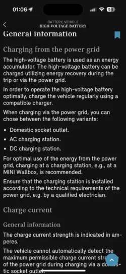

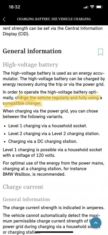

I don't care one way or the other, but I love a good mystery, especially one that lends itself to testing one's google-fu...are there any BMW owner's manuals out there with the same recommendations?
What’s odd is that I’ve always referenced the 2022 manual pasted above at the Mini website which now that I look is different than the motors guide app for the 22 which states 10-80%.

I'd advise anyone with a concern besides myself to contact BMW directly for clarification, as I just have. The idea that the instructions have changed YoY without any rationale provided warrants some concern.
I have charged my 2021 SE to 100% almost every day, and I have over 53,500 miles on it with no signs of range degradation. My Motorer's Guide explicitly states to charge to 100%. I suspect the newer manuals are likely cut & paste from BMW documents or something. MINI recommending 80% charge is ludicrous since the SE has no way to restrict the charging.
Definitely a wording change from fully to regularly. I sent everything to BMW on my end and I really want an answer.
