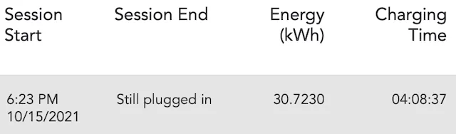

An example of a home, L2 EVSE, a JuiceNet 40 Pro:
  • 67% charge limit - Tesla Std Rng Plus Model 3, 2.5 years, 54,000 mi
  • 30.7 kWh charge to 67%
  • 02.0 kWh - indicated 8 mi at .25 kWh per mile
  • 32.7 kWh estimated for full 67%
  • 48.8 kWh estimated 100% SOC, 32.7 kWh / 67%
One advantage of a network linked, EVSE, is capture of charging metrics to track the capacity of the EV battery. An L2 charger limited by the Tesla to 32 A, it was back to 67% by 10 PM.
GOOD LUCK!
One advantage of a network linked, EVSE, is capture of charging metrics to track the capacity of the EV battery. An L2 charger limited by the Tesla to 32 A, it was back to 67% by 10 PM. Bob Wilson
Can't you do that with your phone or on your computer at home? That's what I do with my Kona when I am charging at a free remote charger (15 min walk from home). It communicates with the car, not the charger.
