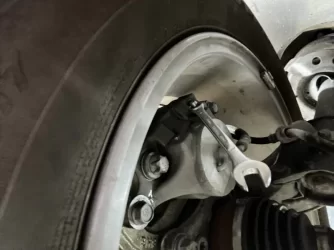

Just before I went on my test drive I snapped a photo behind the wheel to see if there was any fluid spilled. Good thing I did...
