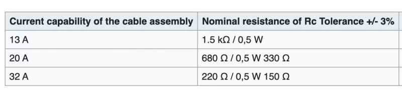

More specifically the J1772 handle latch release button,when pushed - it signals a proximity detection circuit which should in turn command the cars on board charger to stop drawing current immediately.
I have never noticed that. I have certainly depressed it and pulled and pulled until my eyes bulged out but I have never pushed, held and waited. If I'm ever in the situation again I will try it out.
I've never used a Type 1 plug myself but I understand that the latch opens the Proximity Pilot circuit which is a loop inside the plug from PP to GND with a specific resistance indicating to the EV what the current capacity is of the attached cable. I would have thought as you say that depressing the trigger would actually stop the EV from charging. So, does it and how does the solenoid lock come into play? I wonder if the action of the solenoid locks the latch so it can't be depressed?
The solenoid does indeed lock the latch. I tried today pushing the trigger and holding and no white ring light for me. There was a brief pause in the charging indicator (a few seconds) - not enough time to see the dash display readout. The EVSE also indicated still charging during this time. So its back to start the car and set the charge level lower than SOC to stop the process.
