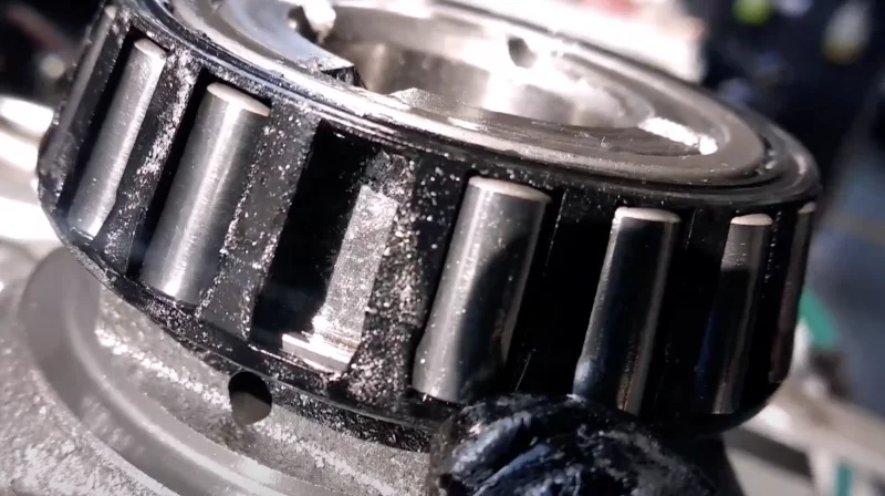

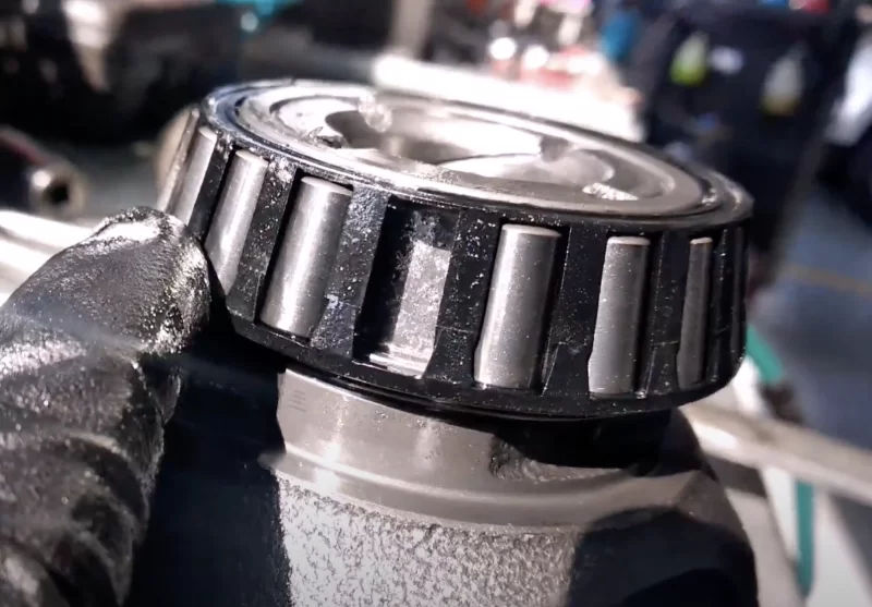

Might be of interest to those who have experienced problems with the reduction gear: Ukrainian mechanics dismantle the unit and reveal the cause of the problem. Starting from 4:17
I wish the youtube video had English captions, but right at the end it was pretty obvious what had failed. Not at all clear *why* it failed.
I have always been curious as to what the insides of the reduction gear assembly looked like. Now I know. I didn't expect to see tapered roller bearings

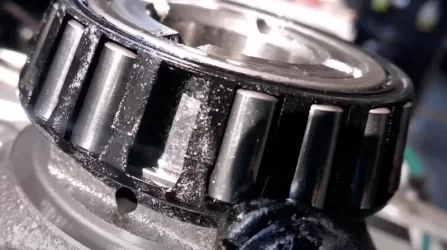

In comments to this video the author mentions bad quality of the roller bearing as the cause. AFAIU the faulty bearing makes the gearbox vibrate and this leads to damage of the splined connection between the motor and the gearbox. In case of prolonged intense vibration the electric motor’s output shaft bearings can as well be damaged. This is why it’s becoming necessary to change the motor together with the gearbox
That bearing was certainly the main problem in that case, but bad bearings don't necessarily explain the various attempts at repair by rotating the motor or lubricating the splines that I read about. It's possible those "remedies" were just the engineer's attempts to see what sticks I suppose.
A missing roller would absolutely cause a rhythmic thunk as the inner race dropped down into the gap with each revolution of the roller cage. Must've been hammered to sh*t!
As for why tapered roller bearings are used, they are very common on drive differentials as far as I'm aware. They're typically specified whenever axial load is expected, and used in pairs if the load could be in either direction. I don't know how much axial load can be expected on a front-wheel-drive differential (don't the driveshafts already have splines to change length as the suspension travels?). Rollers also have a larger contact area than balls do, so you'll see roller bearings where there are higher radial loads... but again there should be little radial load on that shaft; it's not supporting the weight of the car or anything!
Stranger still is they used ball bearings for the rest of the gearbox. The helix cut gears produce some side thrust but I guess they figure the ball bearings can handle that (angular contact type perhaps?).
It looks like there was all sorts of metallic debris that seemed to have gotten mixed in with the grease. So was the roller missing all along, or did it disintegrate and wear down until nothing was left? But what's special about that one roller that caused it to disintegrate? I saw signs of metallic debris elsewhere in the video, but I didn't spot much of anything else that had huge amounts of wear on it. But we didn't really get a good look at all of the mating surfaces.
Earlier in the video, they focused on the half-shafts, and seemed to be pointing something out - possible some wear? Later - when the gearbox was still in the car, he was pushing on that shaft with a wrench, and noting slop where there should be none.
Then there is the question of whether this was a one-off, or whether this is the same the failure that other cars have? We normally never get to see the things when the gearbox is replaced - AFAIK, they go back to Hyundai for whatever reason.

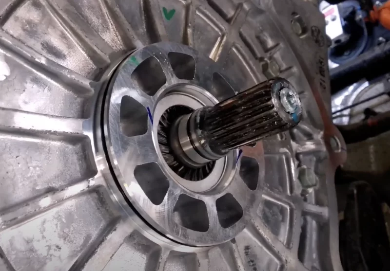

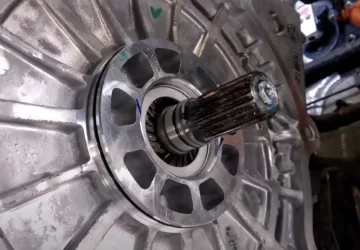

Actually looks like the axial bearing for the differential gear is the cause of the issue, not the motor spline shaft bearing as indicated by this diagram:
https://www.insideevsforum.com/comm...g-vibration-type-sound.7262/page-8#post-96897
Could be a valid point on the dissimilar metals expansion/ contraction ratios.
Which would also indicate that the "turn motor shaft 180 degrees " as a first step to repair diagnosis, would in this case prove didily squat, except to prove that it is not the gear near the motor shaft that is the issue- still needs a new gearbox, just not necessarily a new motor as well, unless as mentioned the noise has gone on long enough to cause other issues such as lubrication in the area around the motor shaft bearing.

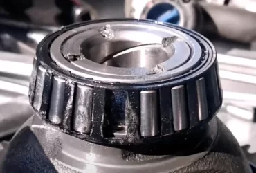

I suspect it was missing the entire time. There doesn't seem to be much damage to the other rollers and the cage looks to be in very good shape; not something I'd expect if there was jagged chunks of hardened steel tumbling around in there. I also can't imagine it wore away to absolutely nothing, though it's possible it wore so much that it fell out upon disassembly... still, though, I'd expect more collateral damage.
By the way there isn't supposed to be any grease in that gearbox; just gear oil (that goopy brown liquid). I have no idea what that grey paste is but I bet it's not supposed to be there! Looks like maybe a magnet caught all the debris?

Yep, tapered rollers on the final drive seen out of place in this design, especially since helical spur gears are used rather than hypoid which require tight axial retention. Certainly the axial loading due to the helical-cut gears is at a maximum on this particular shaft where the torque is highest but larger ball bearings would be the correct choice as they don't require a precise preload, not easy to set prior to the cases being closed up. Plus the aluminium cases are not very rigid axially and a suitable preload of perhaps several 10s of kg might not be maintained over the entire life. Tapered rollers must run with enough axial preload to keep the rollers geometrically in place when under maximum radial load. Mentioning the Chevy Bolt, they also got the primary shaft bearing arrangement correct as well, all following good design practices.
I find it difficult to believe that the missing roller had completely disappeared yet didn't significantly score the races or damage either the roller cage or adjacent rollers. It seems to have left the cage in such good condition that I have to wonder if it dropped out during factory assembly as the play was evident before he disassembled the gearbox. The silver-coloured debris he pointed out at the inner raceway looked to me like aluminium filings, as did the debris in the sump. The rollers and raceways are hardened steel and won't go anywhere without a massive fight and leaving obvious damage.
Another puzzle is what appeared to be damage on the motor shaft nose and if the missing roller was the cause. It seems a bit far-fetched to me that there is a connection but it's possible if the driver ignored the resulting noise. On the other hand, from a statistics perspective, it's unlikely that two independent defects would appear at the same time.
I am kind of thinking out loud here. Part of me has a hard time believing that they could assemble the thing with a missing roller and not notice. Did they fall out in the factory during assembly? Were the things missing even before they reached the factory?
But I agree that it is also true that if there were a roller there which failed in some manner (seized, for example), the collateral damage would be considerable - more than we see in the video. Unless just one of the rollers hadn't been properly heat treated, but that would still cause a lot of damage.
As I look at the video again, that "grease" as I put it starts to look more like iron/steel fragments in the vicinity of a magnet - possibly with some gear oil still mixed in. And there is some of this stuff in both halves of the case, but that would imply two magnets, which doesn't make sense.
It does seem that the debris is clearly centered around one tapered roller bearing so I'll agree that it seems to be a single roller failure even though I've never seen or heard of one that didn't damage all the other rollers and raceways. I'm a little surprised that we didn't know about this video earlier.
I didn't notice a sump magnet nor is there evidence one is included in the drain plug, but perhaps I shouldn't be surprised. The resting location of the debris looks due to that being a quiet place in the oil turbulence due to the small dam.
10,000 (kms assumed) according to the reply to the second comment.
I'm not seeing any damage elsewhere in the gearbox but all bearings would have to have been replaced to do the job right. Gears are fairly robust.
Note that a single missing roller on the differential shaft would theoretically produce a clunk at half wheel speed and most if not all reports have the noise placed at motor speed. However it could clunk at several points in the rotation due to the instantaneous compounding of radial forces on the bearing.

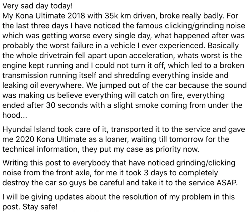

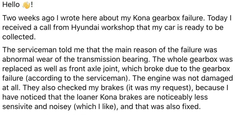

One owner in Iceland did have a catastrophic gearbox failure about the same time as this video was made. The FB posts are the last 2 images.
Here is a hypothetical. What if you had a progressive failure of the roller that started with a flat spot forming on the roller? The ticking noise from a flat spot wouldn't be at shaft speed - it would be at some multiple of the shaft speed.

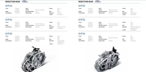

My impression is that Hyundai/Kia is not capable of finding the gearbox design or having problems to produce it with the required torque/speed ratio. Enclosing an extract from Hyundai datasheet with manufactured reduction gear. Notice that model G1F24 used in Kona and Niro (and probably 64KW Soul) has lower torque than G1F30 used in 27KW Soul, while the speed of 12'000 rpm is higher than 10'500 rpm. This doesn't correspond with increased torque of the traction motor (285 Nm for 27KW Soul compared with 395 Nm for Kona and Niro). This could explain why the gearbox is getting damaged in some cases, maybe it's related to the aggressive driving style.
https://www.hyundai-transys.com/resources/upload/ko/product/Powertrain.pdf page 24
