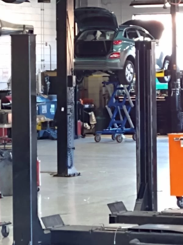

Got the battery replaced!
After 6 months of trying to get a new battery, the day finally came (15000 miles on the car, located in Long Island New York). After dealing with a few Hyundai case managers, different local dealers, many service managers and service associates, all went well once the battery finally arrived. It took about 5 hours to complete the job. Took the car home and charged to 80%. The next day I took it for a 160 mile test drive. Stopped at one DC fast charge and charge to 80%. All systems are working as they should and I don't see any difference in range, I keep very accurate data and it looks to be exactly the same. Planning on charging to 100% when I can squeeze in a 100 mile road trip right after the charge as to not keep it sitting at 100%. I will certainly post any updates as needed.
Charge to 100%. No problems at all!
