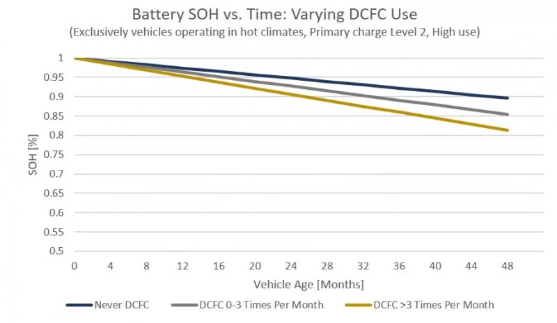

Here's an example of fleet data from 6000 EVs that clearly shows DC charging results in ~10% more degradation over 4 years:
"Exclusively operating in hot climates" seems a bit specific, and even so still less than 20% degradation over four years. MINI has put in enough buffering so we don't have to sweat the 80% maximum charge like Tesla owners. I'm not going to worry, my car will be paid off before the battery fails, so I'll enjoy it while I own it.
