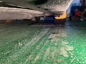

Yes, but all covered up by the felt belly pans. PITA. As for the plastic Jack points, the QuickJack didn’t mash them so I think they’ll last just using the flat blocks. The problem with using pucks in them with the QuickJack is the relative slickness of the differing PU or rubber compounds, so any slight jerking or unevenness in the lift could lead to… a lurid moment or six (ask me how I know). Aluminum pucks might be better, but after just going flat, I’ll keep doing that until I decide to replace the mashed jack points.
I use the factory jack points if doing one wheel. They are replaceable and will take some abuse. I jacked up the whole backend recently. No visible centre point and I didn't want to pull panels to find one. I ended up jacking around a a bolt attaching battery pack to subframe part way along bottom radius arm. Worked fine. There is a sturdy piece of subframe under the battery pack flange. Once high enough, concrete blocks topped with wood under the proper jack points.

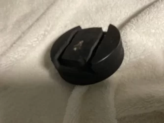

I put permanently 4 hokey puck into factory jacking points that way I’m not squishing under carriage or HV battery specifically when car is for service and “ Mechanics “ damage a car
