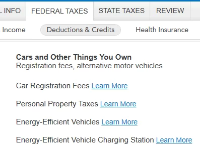

Which section in turbo tax is the ev charger?
For example, the ev credit is under deductions& credits> cars and other things you own> energy efficient vehicles
Federal Taxes->Cars and Other Things You Own->Energy Efficient Charging Station
It was actually there last year.
