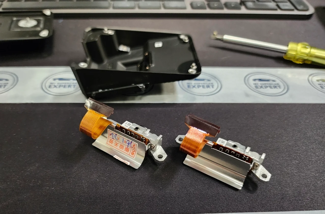

It is 100% your windshield camera, near the rearview mirror, overheated. There are threads on here about it. Buy a used one on ebay and it takes 5 minutes to snap it into place- problem solved. The dealer will charge you 2-3 grand. A used one is between $350-$650 depending on the seller of the used part. You want a used camera, so you dont have to have it calibrated.
You dont have to calibrate the one I linked to above.
This is the camera module that goes bad.
Sorry, I meant that if you buy a new camera module, you will need it calibrated which is several 100 dollars. Either a used module or the internal piece that you bought won't require calibration.
