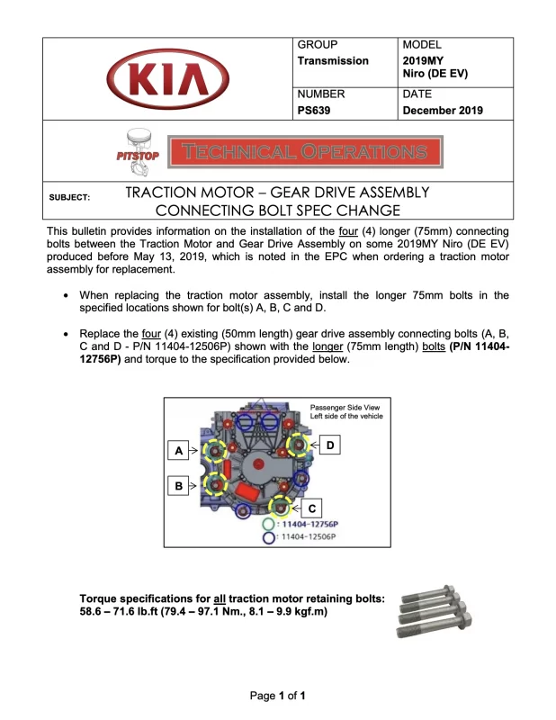

This document seems to provide some insight.

Really? Were shorter bolts loosening themselves or something??

It seems more likely that the relevant motor flanges are thicker in the case of a replacement motor. 50mm to 75mm is an awfully large difference, or mistake to make on the original fit. The mystery continues ...
Well, they did find signs of fretting between the two parts when they replaced my reduction drive. So that does give more credence that a stronger mating may have been necessary.
My 2019 Niro was built 08/2019 (after this bulletin applied) and developed the problem and had a motor replaced, so we know that the longer bolts are not a solution.
Hi, so are you saying you had the first gen motor, thicker flange and longer bolts and it still failed?
... so we know that the longer bolts are not a solution.
I don't think the TSB was intended to be a solution. It's purely an alert that the replacement motor requires longer bolts, presumably a safety issue which may be why it's logged with the NHTSA.
I'm due for my first year service soonish and I'd like to know the details of the new motor, flange and bolts before I head in.
Can anyone confirm my thoughts.
New motor has a thicker/bigger mounting flange and thus they need longer bolts to mount it? Or is the mounting flange a separate thing?
