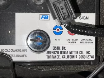

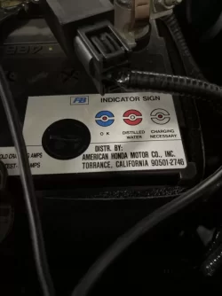

If it is an original battery there is a sight glass on the battery. Blue is good and white means needs charging.
There is a chart on the battery. The blue is very conspicuous.
The battery that came with my 2018 does not have a sight glass. I wonder if Honda didn't put the same battery in all cars.
