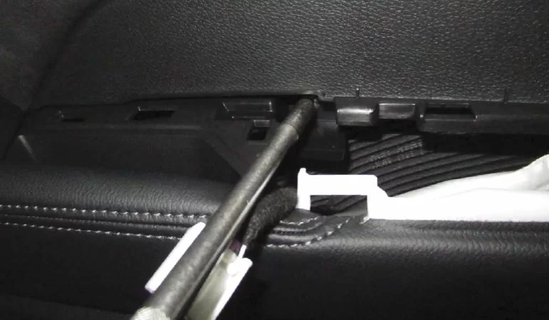

sniwallof, how much work was it to remove the door panels? That's my main cause of hesitation for replacing the woofers. Don't want to risk adding any potential rattles or buzzes after loosening the fittings for the doors.
The worst part are three little steel clips near the door locks. They are very hard to pull apart and bend, and fall out on the floor. A dealer said that is par for the course, difficult for them too. Don't forget the big philips screw inside the removed door switch panel too.
The plastic clips come out relatively easy, and I have not had any new sqeeks or rattles since the project. I think I made a later post, I ended up not liking the infinity speakers, the new ones, I think they were kicker, are much better.

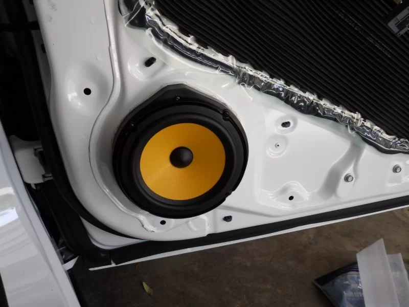

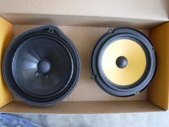

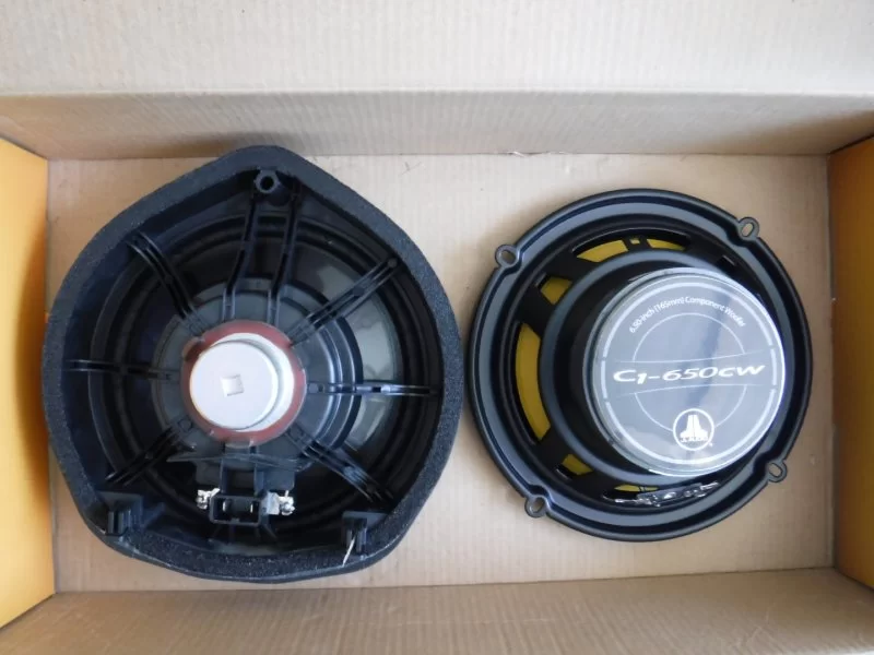

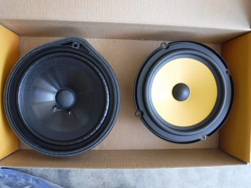

I finally took the plunge after just deciding I didn't like the clarity speakers. The tweets are ok, kinda harsh sounding, but the mid bass drivers are so muddy at any volume that I decided it was time to upgrade them all. Man those are some tiny magnets on the door "woofers." Crutchfield first recommended the Rockford Fosgate Prime R1675-S as they are on sale and I do like RF products. As much as I liked the mid-bass drivers (I have heard them and still feel they would have been fine) I hate those tweeters, and they are physically a challenge to mount. I decided to go with the JL Audio C1 650 component sets for front and rear replacements. The tweeters fit perfectly in the front pillars. Removed the factory plastic mount and use the JL bracket kit, no crutchfield metal strap required, easy and look like they were OEM in fit/form. The tweeters in the rear door were a bit more brutal, as I had to cut out a lot of the mounting frame to high temp glue and silicone them in. You can't tell from inside the car and so it looks factory. The mid driver/woofers with the Crutchfield adapter frames were a breeze. As for sound, I am happy. The overall "clarity" is much better and the range is much wider in both response and un-distorted volume. I don't think there is much more that can be done on the low end without a real sub-woofer, but I am stopping here. If the factory unit had more RMS power available I might have chosen Focal ISS 165's, as I think that is about the top end for a non-amp "factory" system, but you really need a bit more power than the spec on the Clairity factory system. If someone has tried them chime in, they are good drivers and have a pretty flat response curve.
The JL's are pretty efficient and the factory unit drives them well. It's a price point call, if you are not adding an amp and sound processor, spending $500+ on factory replacements has diminishing returns. But this is just my opinion. I bet someone has gone the RF 1675 route and can chime in - they probably sound fine and anything is better than those factory speakers.
If you really wanted to get more out of the doors you could build a custom low resonance baffle and use lots of panel sound deadening - but if you are going that route you are probably adding amps, processor, and $500 a piece drivers - and enjoying the feeling of watching your range decrease as the volume increases! But we all have our priorities, and I was once there in my youth - at IASCA... ;-) (Hmmm, 17KW battery.... no - walk away...)

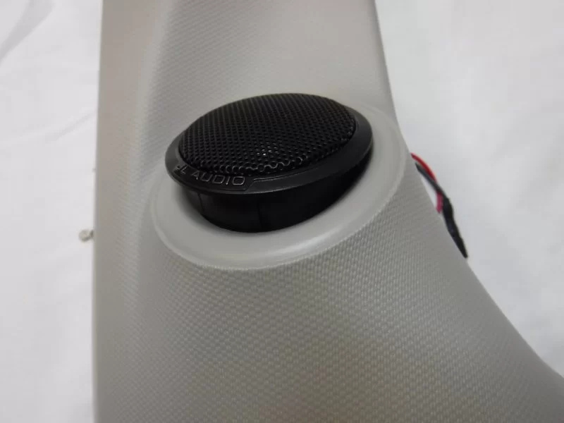

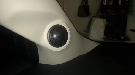

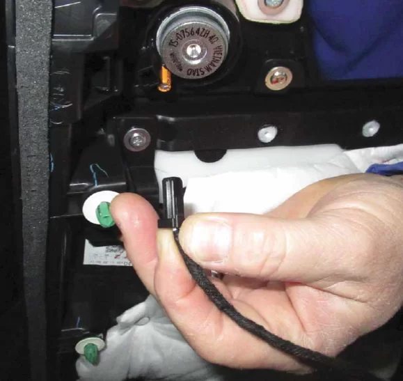

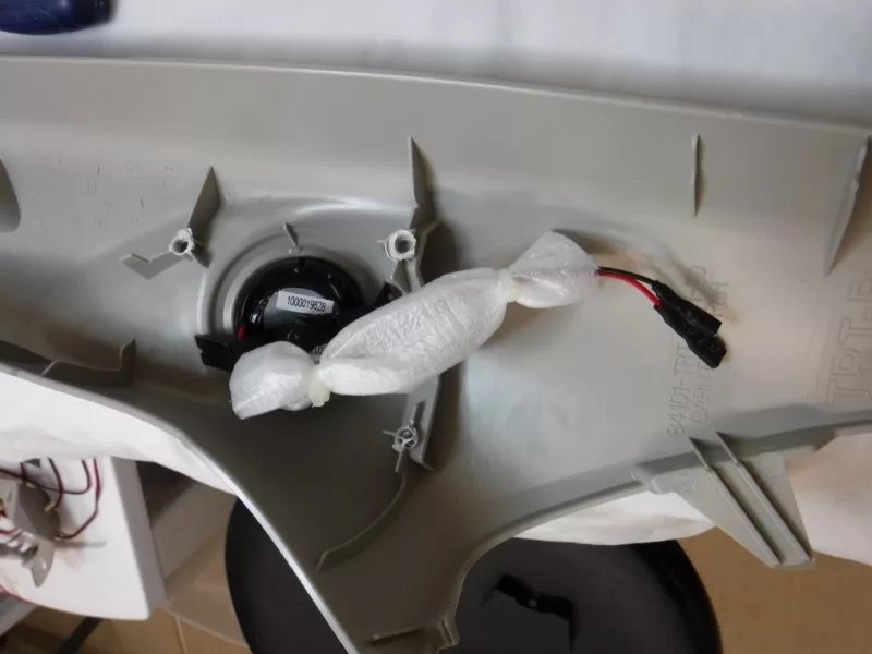

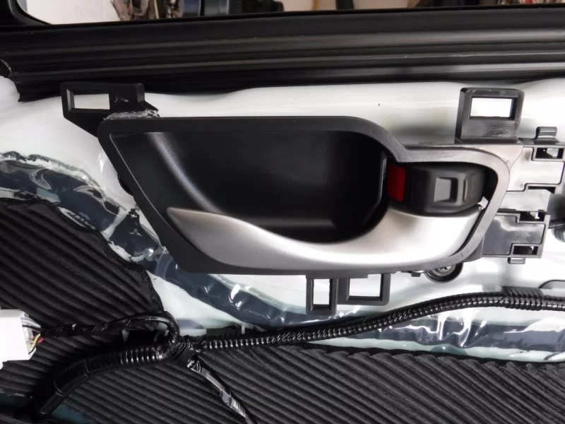

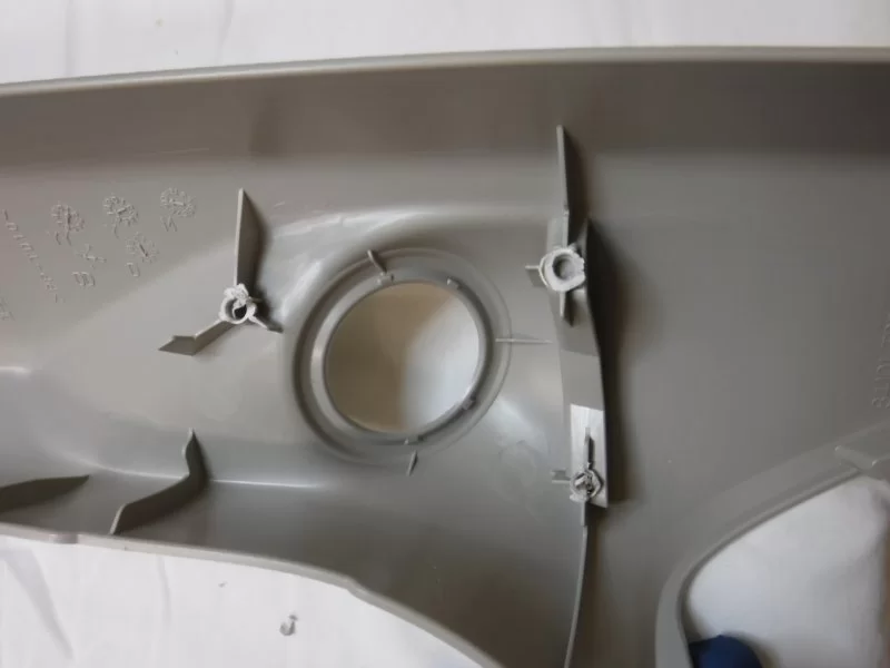

The install was easy and everyone has already commented on the procedures and things to watch out for. I am including photos, not that it is anything special, but may help someone else. I am happy and it only took an afternoon once I got into it. Have to admit I freaked out a bit with all the errors after plugging the battery back in, then read the manual (have to order the real owners manual... $40K car and they deliver it with a "quick reference guide" ugh.)

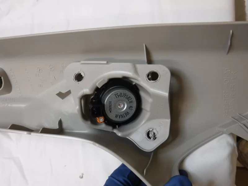

For me it did fix the rattles (in the A Pillars). The rattles I had were from the plastic facotry tweeter mounts that are plastimelt secured to the pillar frames. When I removed them and installed new tweeters with metal spring steel mounts the rattles went away. I still have a small rattle in the right door but it is extremely minor and I will fix it with foam tape at my next opportunity. I recommend when you do the replacements, don't spare the high temp hot glue or silicone. They are not structural for mounting (have something solid for retention) but are great for stomping out rattles.

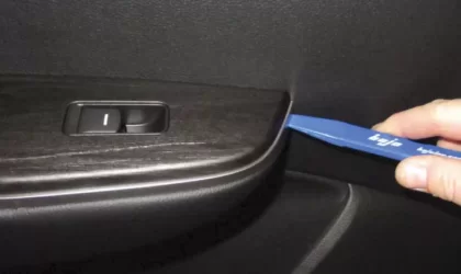

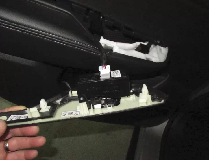

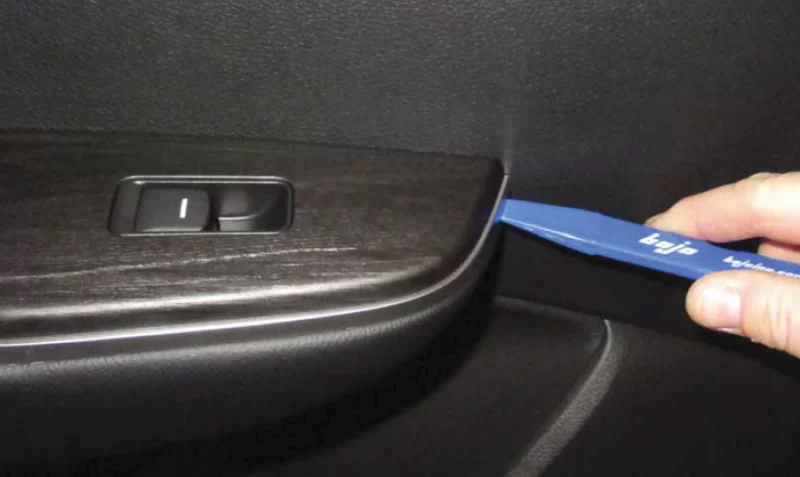

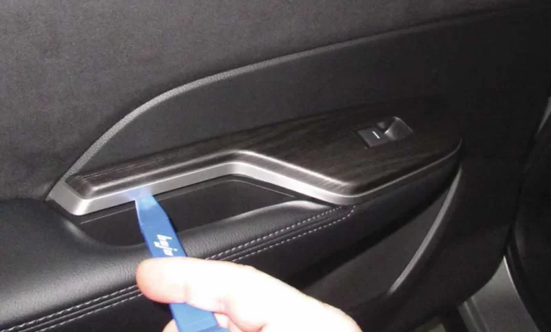

Yes, you have to remove the door panels. It is not that difficult, pry up the control panel and remove the single Phillips screw. Then pop out the plastic retainers all around the panel. The REAL BEAST is the 3 metal retaining clips that are holding the panel against the door open handle. You have to push against the door handle (door latch) while pulling the whole panel out with a VERY slight twisting motion. Those things are in there tight and you may either break one of the clips, the plastic mounts or both. The door handle stays on the frame, you are separating the panel from the door handle and frame. However, for tapping the speaker leads you may be ok just going into the B pillar running trim wire bundle and pulling those out there versus from the door. I will say that upgrading the door speakers is worth it. Once you remove the factory mid drivers life is better.

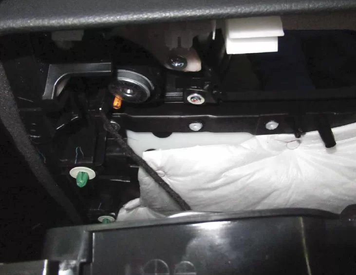

Photos attached. I also know that Crutchfield is working as quickly as they can to produce a master mod sheet for the Clarity they have some data now but are working on a full retro fit guide. Give them a call if you got your stuff from them, they have some guides.
Good luck and let us know how it goes. Take photos! I am still interested in a sub, as although the C1's are MUCH better than OEM, I still miss my sub 120 hz.... ugh...

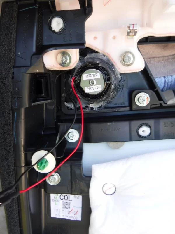

Great suggestion! accessing the B-pillars seem much less work than going inside the door. Any chance that you’re still remember the wires color code, especially the polarity?
Sorry, I just looked back through my photos and I can't tell. Since I used Crutchfield adapters I didn't pay that much attention to it at the time. Funny, I normally note such things. I would say this but it is not a sure thing. The switch panels (expecially the rear doors) are super easy to lift out. You could note those wire colors and then go by process of elimination. I remember they were standard in that if it was blue or pink, the other was blue with white stripe etc as a pair. The set running into the door should be pretty small (just the door lock, windows, and speakers). The rear doors have the speaker wire split between the driver and the tweeter, so there should only be one pair of wires in the bundle heading into the door. As for polarity, I "think" the solid was positive, but now sure. However, if you are installing an amp and woofer, then you can adjust the phase at the amp after doing a frequency response test post install. Most trunk installs benefit from a phase alignment anyway.
