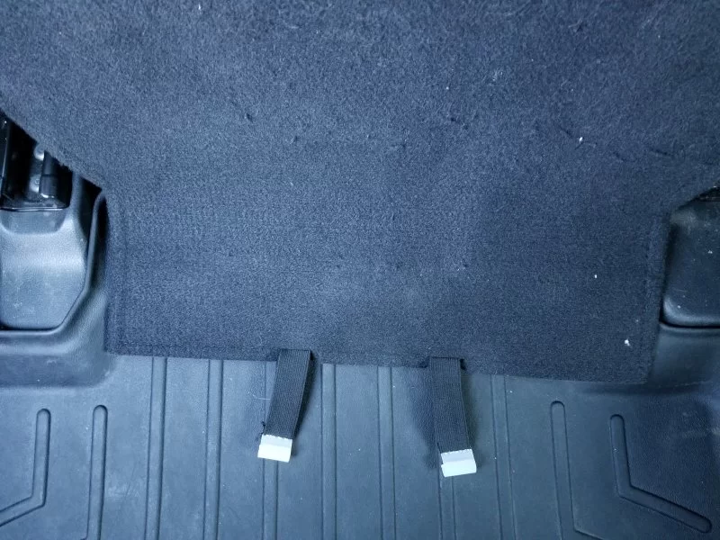

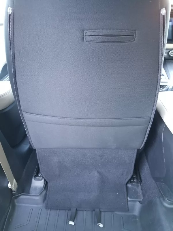

I disconnected the J hooks at the bottom of the seat back cover and unzipped the rear drivers cover, then flipped it over the top of the seat to get a look at why these seats are so bad.

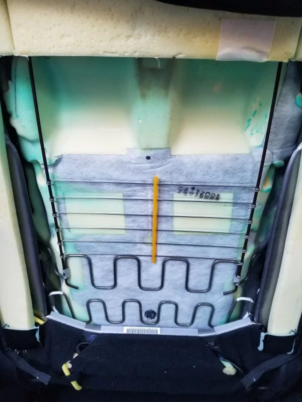

It appears that the foam is solid and firm, but there is little to no support for the foam.

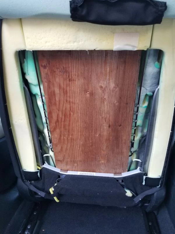

I cut a 10" x 18" piece of 1/2 plywood and inserted it into the seat frame to support the foam and it feels great to me.
Very good lumbar and thoracic support for my spine.
Easily modified if I need to shim it anywhere (or remove it completely).
Requires no fasteners, but I will evaluate as time goes on in case the plywood shifts at all.
This is the way I would have liked the seats delivered by Honda.

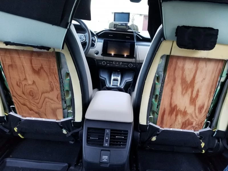

Attached pictures as requested.
Plywood slides up into frame slot at top and then into bottom slot
My back may be unique, but this change makes me look forward to drives anywhere in the Clarity.
Support is improved along the entire back for me.
I would have rated the seats at zero before and 100 now.

I lucked out with just bracing the saggy springs, since the cushion is already designed/shaped very well.
