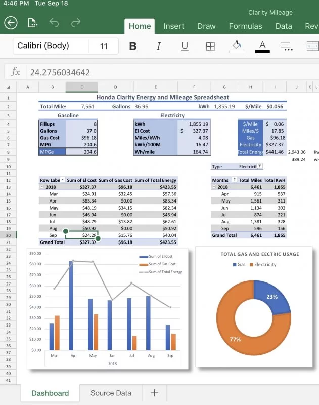

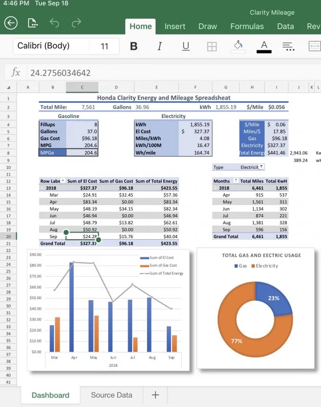

Haven’t really done as much analysis but here’s a screen shot of a spreadsheet I’ve been keeping since purchasing the Wi-Fi EVSE unit. Might shed some light on the conversation

Haven’t really done as much analysis but here’s a screen shot of a spreadsheet I’ve been keeping since purchasing the Wi-Fi EVSE unit. Might shed some light on the conversationView attachment 2396
So cost equal to a Prius hybrid- but you get such a better ride and much more comfort and safety as well as burn lots less gas
