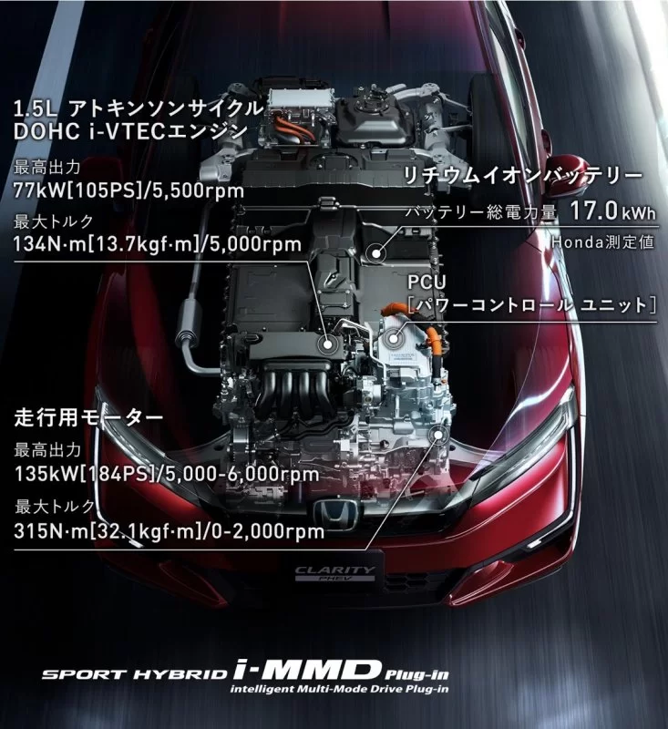

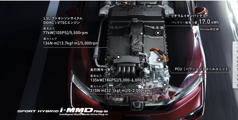

In this picture, it states clearly that it has 17kWh battery.
ATTACH]
Your image didn't appear in my browser, I see only a broken icon.
Still, I'm perplexed that Honda would make two different 17 kWh batteries in the same shape for the two markets. I believe that the Japanese Clarity PHEV must have a different built-in charger to accommodate faster CHAdeMo charging. This charger could limit the recharging speed to whatever the maximum the battery in the US/Japanese Clarity PHEV battery chemistry can safely accept. Even if that recharging rate doesn't match a Tesla Supercharger, it would still provide a quicker recharge than the Level 2 port. Does any of the Japanese literature provide a CHAdeMO recharging time?

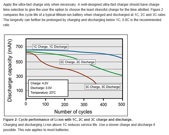

I seriously doubt the battery pack is any different from the North American model. There doesn't seem to be anything inherent to the nickel manganese cobalt battery chemistry Honda is using that would preclude DC fast charging, as NMC cells are used in other EVs that do have fast charging like the Nissan Leaf.
