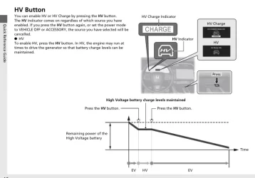

I think I've seen something similar, where after one press of HV, I thought I was on engine only (present battery state in reserve), however, the battery continued to discharge (less battery bars). The manual seems to say that shouldn't happen(?). Our first bug?
Also, once I had to pull over and turn the car off, before I could get back to EV mode. Pushing HV did not seem to return to EV mode (I may have done some stupid sequence without realizing it, so not ready to say there is a problem for that one.)
It has been too cold for me to test HV mode much, but it should act as hold mode. How long did you give it to start the engine? It is possible it won't hold above a certain state of charge.
I started out at 34 miles (full charge for the 9F temp we're experiencing). At about 14 miles remaining, I hit the HV mode button and although the HV indicator showed up in the center dash, it never actually went into HV mode. This was obvious from the continued diminishing of the electric range listed. There was also no sound from the ICE, which would have been obvious at these temperatures (the ICE is not quiet at single digit temps when just starting up).
We were probably driving about 20-25 minutes at the time I hit the HV button.
I had the same sort of thing today, but I had switched to Sport mode from Econ. I was expecting the line from blue to white on the speedometer display to change to show the new demarcation mark where it is supposed to switch from ev to gas but nothing changed. It did say SPORT on the display and the lights at the edges turned to red but I don't know if the car actually switched modes.
Don't know if there's a reason it won't hold at any charge level. On the other hand, if you double-click HV, you will put it into an HV Charge mode. In that one, there is a published 57% battery capacity limit to the recharging. I have tried that one out, but not to the 57% max limit. It adds charge fairly rapidly when you're driving at highway speed.
