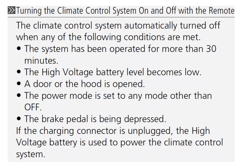

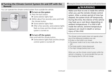

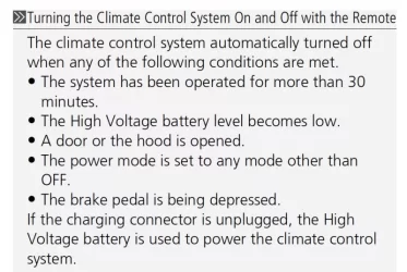

Any chance you are turning it off by accident when checking to see if it works? Opening a door turns pre-conditioning off.
I was surprised by the open door thing. I think on the Volt it was when you actually started the car with the start button (if it had not gone off by itself before than). That was better, for example, if you went out to put something in the car ahead of time, you did not turn pre-conditioning off!

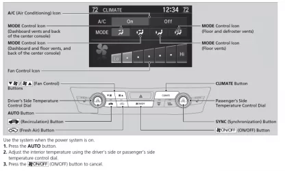

This is a shot in the dark, but might be worth a try: Check this climate page and check "OFF" for A/C: (also, at least on the iPhone Honda App, the app gives the cabin temperature during climate pre-conditioning.)
Ah, still may be worth a try to confirm A/C is off, but I just noticed that in "AUTO" both of the climate page A/C buttons go off ... (PHClarity2018 just posted this too, thanks)
Another idea, I have not been using eco mode, but I notice that if last used, next start up eco mode comes on. Try turning off eco mode before shutting down the car too. (so be in climate "AUTO" and "normal" mode, confirm that the eco icon on the driver display off).
