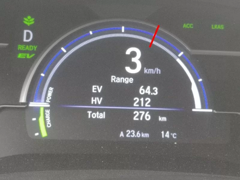

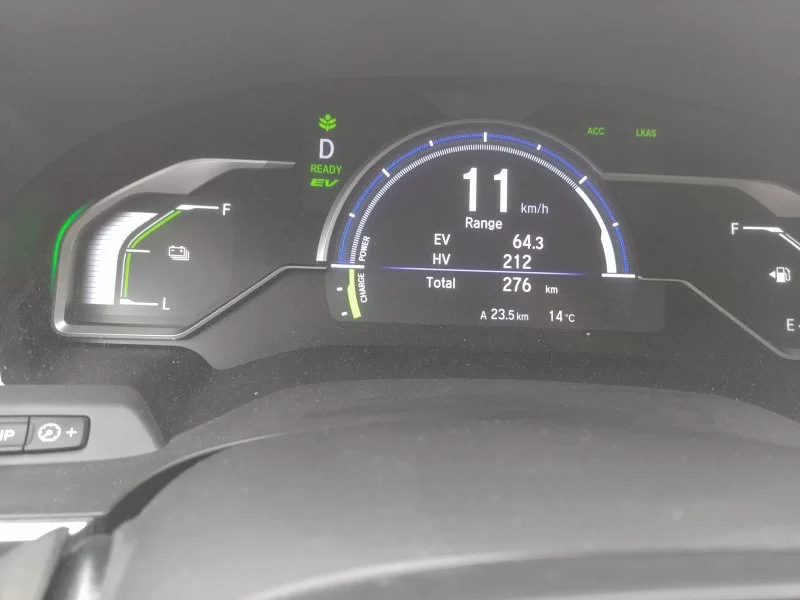

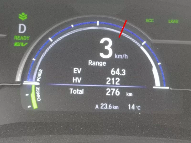

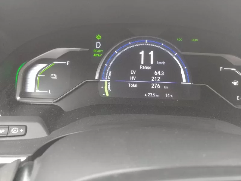

I tried several different acceleration levels and I noticed that as soon as the power meter reaches the level indicated in the picture I attached the ICE turns on again.
This is a picture I took during my drive this morning of the instrument cluster while this ICE turn on was happening.
that is a power level so it can be reached with different accelerations at different speeds.
first I did a hard acceleration without touching the switch, power level reached this line below 50 km/h and ICE turned on, and it only stayed on for 5-10 seconds.
at next traffic light I accelerated again, not as hard, power meter line was reached above 50 km/h, ICE turned on for about 10-15 seconds then turned off again.
next light I did a hard accel again and ICE turned on very briefly. as soon as I reached the line and ICE turned on I had to stop accelerating due to traffic, and by the time the power indicator needle had dropped down to 0 power (about 2 seconds) the ICE was turned off again.
After I was on small streets with traffic for 5 minutes and I couldn't accelerate enough to turn ICE on. when I was approaching my work I had a stretch of free road and I did a moderate acceleration. Power meter red line was reached around 60 km/h and ICE turned on. It remained on for about 30 seconds and turned off again.
I read the other message about the ICE turning on in stages until a temperature is reached but I doubt this is what is happening. once the ICE starts turning on for only a few seconds it's no longer doing stages to warm up, and it shouldn't keep turning on like that.
