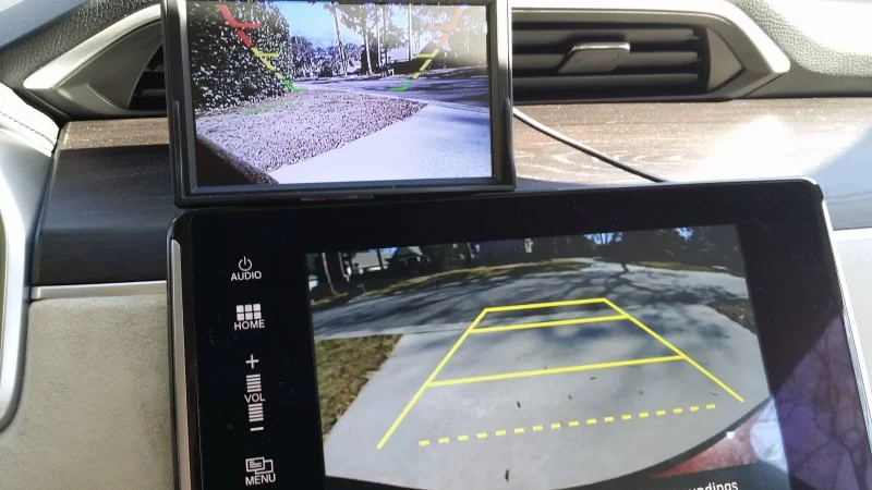

I have completed my first test installation on the left side. Attached is a picture that was taken with the Honda backup camera and simultaneously with my $50 side view camera system. It turns out that its easy to do the wiring and installation without any cutting or drilling. Two 5" monitors will fit perfectly atop the Honda monitor.
I only have one camera at the moment - I wanted to start cheap. The camera is just to the left of the lower part of the trunk lid, on the fixed part of the car. It needs to be as far back as possible. This is the second location I tried. The first did not work out well. I'll send more pictures showing where later in the week. I'll also describe what I learned, and am still learning about cameras and monitors. This test was in my driveway since I wanted time to take pictures and not want to cause a commotion in a real parking lot. This may not be the final setup, but its good enough now to test some more.

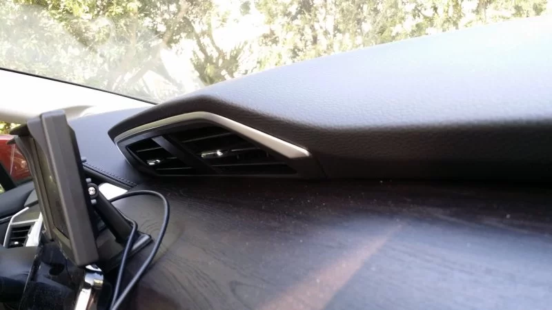

I'm curious how well the air vent works with the 2nd monitor in place. How long did it take to complete both camera and monitor installations? How did you attach the monitors?
Thanks for sharing this.
My estimate is that the project could be done in 3-4 hours total. It is not complicated at all.

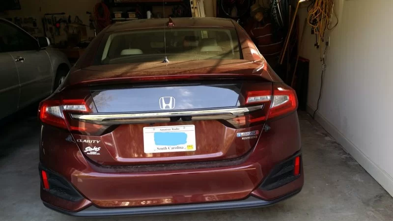

But mine has taken much longer because I spent a lot of time experimenting to find the best position for the cameras considering visibility by the camera, minimal intrusion of the car body into the picture, and some camouflage. The result is shown below. I believe this is my final choice. (At one point I had visions of the cameras making the car look like an old imperial with lollipop lights.)
I'm also attaching a picture of the monitors and vents. I do not believe this will be a problem, and this may be my final choice. But the monitors are just lightly tacked in with Scotch double sided tape at the moment, as a test. That is a solid mount but still permits me to easily remove them without damage. I use the same for the cameras.
