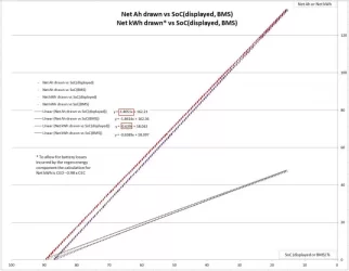

Compare those to the as-new rated capacity of 64 kWh and 180 Ah. I obtained values (in red boxes) close to those in my test below. (Mine are factored by 1/100 because I forgot about expressing the SoC change as a fraction.)
I actually log those values every 5 seconds while driving to check the linearity but that's not required for a simple capacity check.

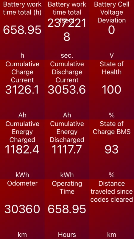

Re posting the screen shot from my Car Scanner app at about 30,000kms. Still at 100% and reporting perfect balance. Interestingly it reports only 5 DC charges where as we have counted 12 by looking at invoices. Have to admit some of those were just top ups.(?)Kona OBD2 info 03-06-23.webp

Re posting the screen shot from my Car Scanner app at about 30,000kms. Still at 100% and reporting perfect balance. Interestingly it reports only 5 DC charges where as we have counted 12 by looking at invoices. Have to admit some of those were just top ups.(?)View attachment 20773
Hello Ferenc, please can you tell me what device you are using with the Car Scanner app to get this information? Based on my guessometer I've lost about 50 to 75 miles of range since the battery replacement. Thanks for any thoughts you may have.
iPhone 6 and LE link obd 2 reader. I have the 2022 model Kona.
