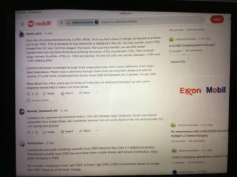

Who I should blame for my problem 20000 miles and I have that issue from a time I bring a car to my L2 charger which was being use on I3 for 7 years as I said I send to manufacture for check up but how to explains public L2 works perfectly good.a charger L2 is Creeper Creek 32 amps As was a problem with chips supplay what year is your SE Mine 2022 A dealer are useless as they have comercial hooks up 208 Volts 3 phase
FYI, a three phase circuit divides the current over three wires, two phase between two wires. So there is more current per two phase wire and that can push a poor/marginal connection over the limit (usually the outlet but could be the car's internal charger).
I talk to my energy supplier and as long I have 240 V .their national standard is 225=250 V. My outlet is Hubbell which is the best what I can have and I have to live with it .My neighbor have 3 different EVs and don’t have any issues with L2 charger the issue is SE in my estimate.After thermal update SE automatically switching to low charging 16 amps .maybe this low slower charging is going to prolong live my HV battery as I never charged on DC

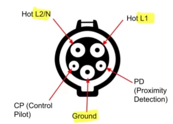

There is no such thing as "208V, three-phase level 2 charging" in North America. Public L2 stations may be powered by common 208VAC circuits, but those are single-phase. The J-1772 standard doesn't accommodate three phases.
I may be out of phases. I'd correct my post if I could.
As I’m really not an electrician I can provide only what I’m reading
Right, but that's not actually "two-phase" charging. It's still split-single-phase, but instead of running 240V potential to ground, it's supplying juice at 208V potential to ground on each leg. So a municipal or commercial L2 EVSE can only charge our wee SEs at 6.6 kW.
Note, I'm neither an electrician nor an electrical engineer; others here have far more technical knowledge and can describe this much better than I am able.
