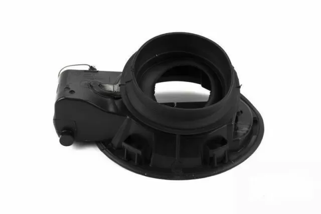

I'm not planning on messing with anything that isn't broken but if mine ever gets stuck, I expect it wouldn't be that difficult to disable the lock mechanism either mechanically or by unplugging the actuator (possibly with an error though).
Maybe there's a way to pull the fuse for the actuator or made some tool/3-d print something to reach in there to open? (just thinking out loud)

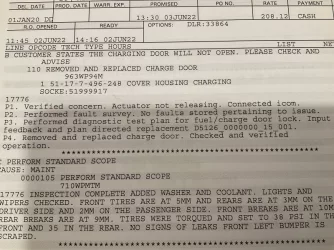

The service person said they’ve replaced a few but not a lot. She also said the replacement part number is different from the original in my car, presumably because mine’s a 2020 which was the first model year. Hopefully this part is more durable and this doesnt happen again. If it does I’ll definitely try to figure out how to disable it, maybe in bimmercode.
It seems basically an identical mechanism as my 2015 Hardtop S had, but of course the door is different with the stamped E.
Am i correct that the inside of the door is different too. the receptacle for the plug cap vs holder for a gas cap
Oh yeah, a slightly different "holder". So the door itself is a totally different part. I was thinking of the latch, and how the flap actually works (push in to open), and the way it locks when the car is locked.
I think they replaced the hinge and guts. Otherwise the door has to be the color of the body and having two of the same color for a SE seems a bit too coincidental.
Maybe this goes without saying, so did the new door/actuator resolve the issue? Was it in fact the actuator?
It is resolved! From the repair document, sounds like they replaced both the door and actuator but it was the actuator that failed.
