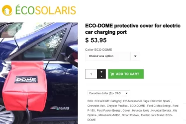

I believe your MINI Electric has a different connector than the J1772 we have in the States. I've had problems with ice inside the charging lid preventing the charging lid from opening, but now I make sure to clear the ice before I close the lid.
I have one of these EcoSolaris Eco Dome covers to prevent snow from getting in when charging outside and it works well.
https://ecosolaris.com/produit/housse-port-pistolet-de-recharge-voiture-electrique-eco-dome/
Thanks for your replies!
Insightman is correct that my car has a IEC 62196 Type 2 connector. (Is this a forum for mainly US Mini owners?)
I asked my local BMW dealer to solve the problem but they only answered it was a known problem with no known solution.
Thanks Insightman for the link to EcoSolaris; this is a good solution. You are better than BMW tech-suppot.

We have more people from the US, but we are not a US group only. Or not even north America like I've seen. A bit surprising that they didn't know of covers to try though. I thought those were common for those in wintery areas. While I am garaged, I knew of them. Hope that works for you.

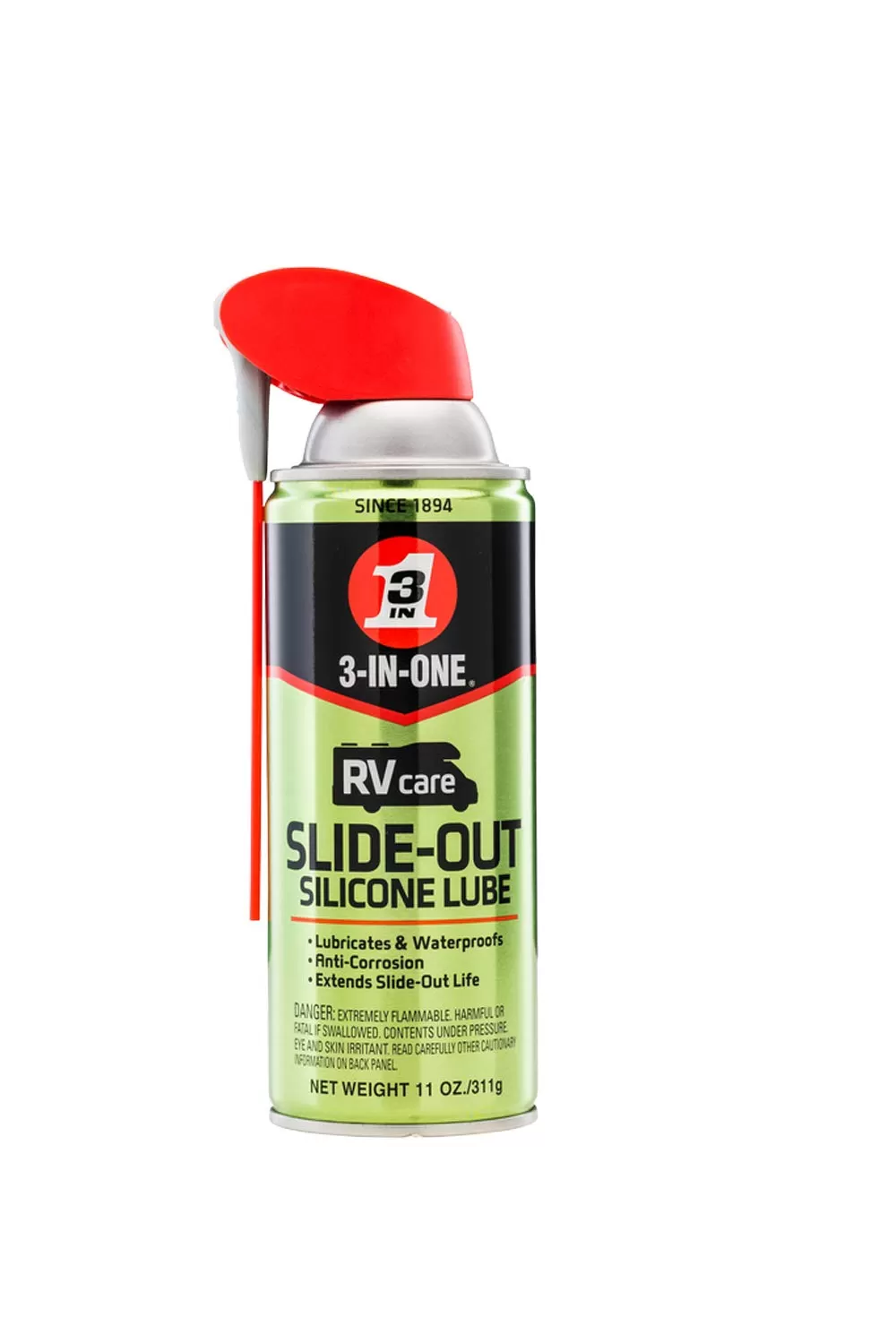

A little spritz of some fluid film or other protective water dispersant could help.
The rodentia of my area like the taste of anything even possibly edible, I don't wish to tempt them.

The box idea and lubricant sound good, but it would be nice to hear something official from MINI.
