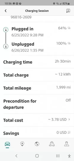

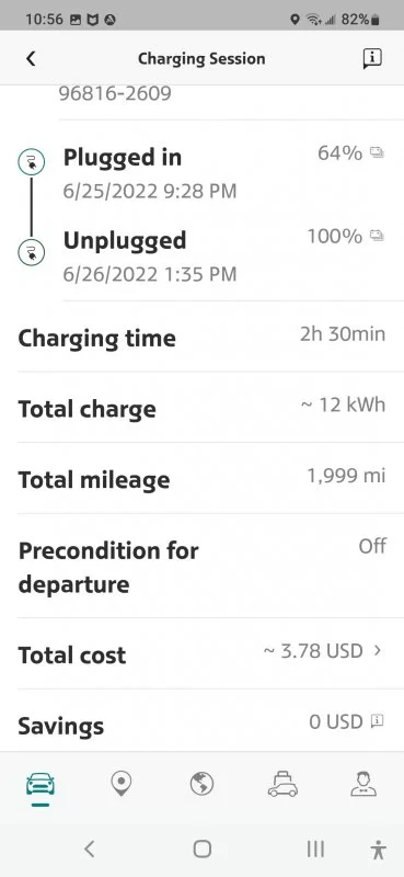

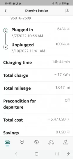

Sorry, I couldn't see my thumbnail screenshots. This is how I compared. Temperature was about the same because I'm in Honolulu. Luckily, I don't have to worry about losing range to cold weather.

It depends what you pay per kwh and what it costs you for a 240 volt charger. On Oahu, the current cost per kwh is about 44 cents now! My screenshots were from a few months ago when it was only 33 cents a kwh. I only spent about $600 on my 240 volt charger and accessories. Bought a manual 2 way splitter that's plugged into the dryer, a 25 ft ev charging rated extension chord, and a 24 amp charger. The circuit for my dryer is 30 amps so 24 amps is the most you should draw. No installation cost.
