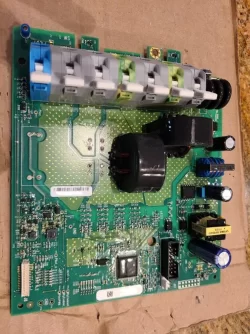

So after multiple times trying to get some sort of resolution with Chargepoint, I decided to take the unit apart. There are two boards inside. They are connected by a board to board connector. My guess is the upper one is the CPU as it has a back up lithium battery. The main board has the relay on it. I tried looking up the boards both with their numbers and QR code but no luck. I decided to try replacing the relay as it did have a number which was easy to find and at 20 bucks if it fixed the problem. See the board with the relay. The cup board has been removed. reat if not I'm out 20 bucks. There are 12 lens that are soldered to the board. I was able to replace the relay. After reassembly I plugged it in and it passed its health check. I connected it to the car and it works perfectly. Please see the attached photo showing the location of the relay. Note: The upper CPU Board has been removed.

Even a blind squirrel finds an acorn once in a while...
It probably helped that I built an EVSE with an OpenEVSE board and display I bought on the internet. I had to source the transformer, relay, box, etc from Ebay, etc. The first relay I bought used from Ebay and it would not work. I think I paid like $10, so I didn't even try to get the money back. I tried a second different manufacturer and bought new (still off Ebay) and have had no problems with that one. I'm glad I guessed correctly with your EVSE.
Yes, thanks for the advice. Chargepoint is absolutely no help. If its not the internet, replace it. It even had a diagnostic port. You would think they would want to know what components fail or the the MTBF would be OR maybe they just care about their commercial stations.

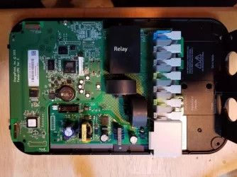

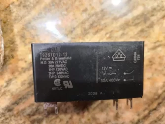

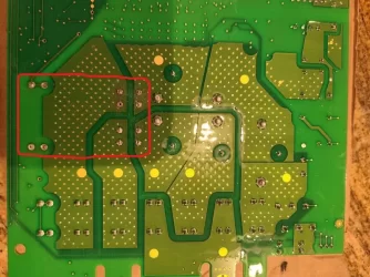

Wanted to add my Charge Point Home 25 information in case it helps anyone else. I purchased mine used recently on FB Marketplace from a seller who said they sold their car an were no longer using it. I have no reason to believe it was exhibiting symptoms based on his use case, which was 3.3 Kw/h versus my 7.6Kw/h. Since I was pulling more amps through it the poor relay connection couldn't reliably sustain the amount of current necessary for long charging periods.

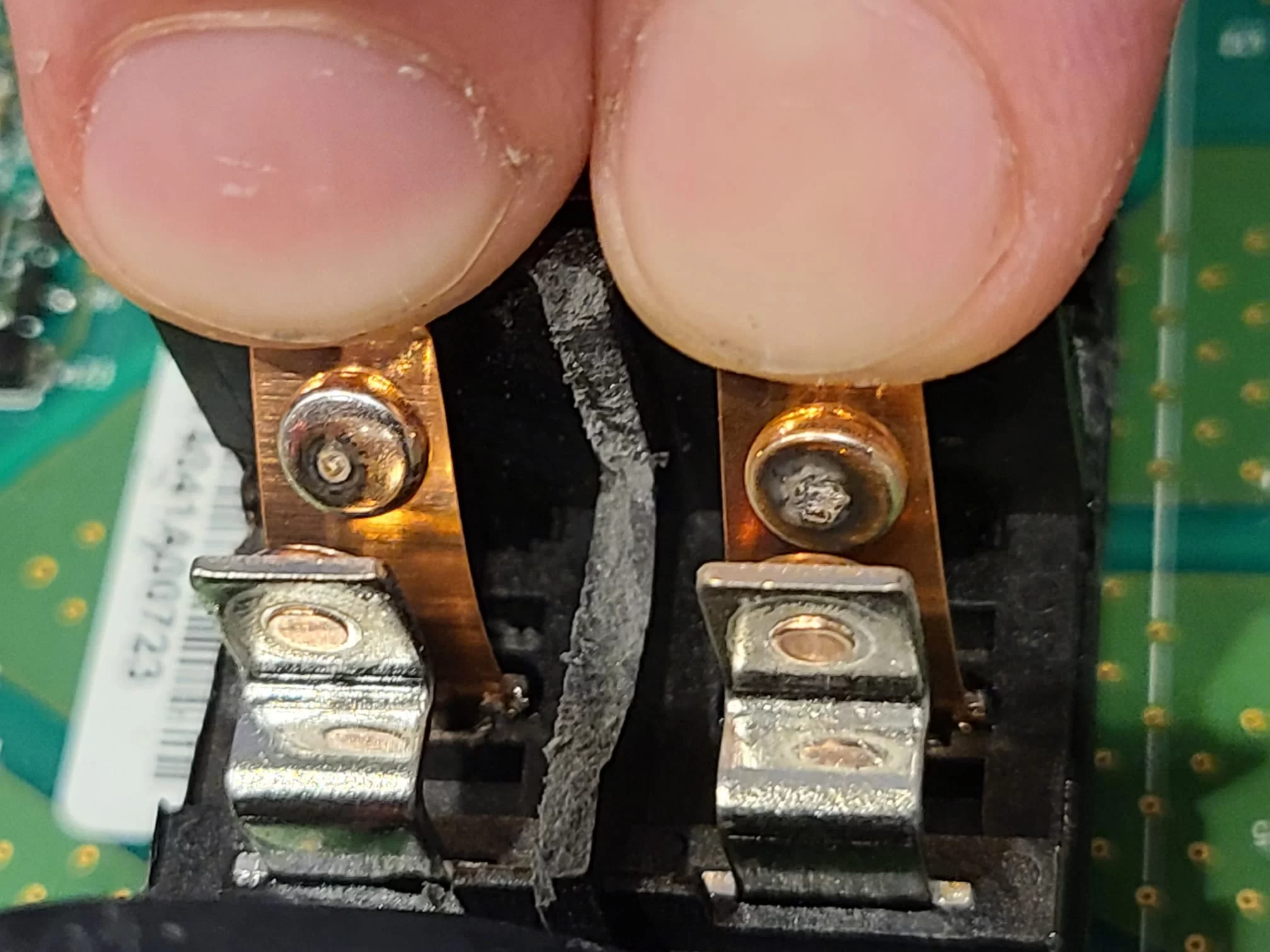

My symptoms were, it would randomly stop charging and surge up and down when it was charging. No errors on the ChargePoint were registered via lights or in the app. I couldn't pinpoint the issue, I thoroughly went over all of the wiring in the breaker panel and outlet and it never did this anywhere else I charged, only at home. When it had this issue it would also throw a check engine light due to a charging issue when this happened.

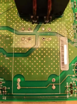

I have attached pictures of the board with the relay removed. I opened the relay to show the problem with the relay contacts which were in pretty bad shape. It is too bad these are such a pain to replace, since I imagine over time this will be an issue many will have unless the design is changed.
My steps to open the unit included using a Torx secure bit to open the back and then access the two boards as previously mentioned. In order to remove the relay, I found it helped to take the plastic apart piece by piece until I could isolate each of the standoffs so that I could cut/break them off clean at the board and then go about using a solder sucker and solder braid to remove and clean up the holes. This is not a trivial task and takes patience and care. It may be frustrating for those who are inexperienced in soldering. Due to the size and amount of thickness to the traces, it requires a lot of heat and care to ensure you don't damage anything along the way. When I replace the new one, I didn't push it through quite as far as the original, so that in the future it would be easier to remove and replace if necessary.
Hope this helps others with this issue. Any questions, let me know.

Added additional pictures at the bottom of this link showing the charging issue in the graphs and list of charging with 0 or 1 miles added over various timeframes when it should have been fully charged, up to 15KW or so in the app.

A thought just occurred to me while reading your post. Your photographic evidence with the pitted contacts implies that the relay is making / breaking the connection under load. As a charge is completed, the vehicle normally tapers the current down and I would expect that there would be essentially no load when the relay disengages. Likewise, I would think that the vehicle would not present a load until after the relay has connected at the start of a charge cycle. This should be conducive to long relay life in the EVSE.
Now, suppose you command the Chargepoint to terminate charging prematurely (before the vehicle is 'done'), maybe it simply opens the relay causing it to arc.
Is there a chance that a user's modus operende can be either 'good' or 'bad' for the longevity of the relay in the EVSE? Do some EVSE's utilize solid-state relays, or would a SSR tend to be too lossy (excessive heat) for this application?

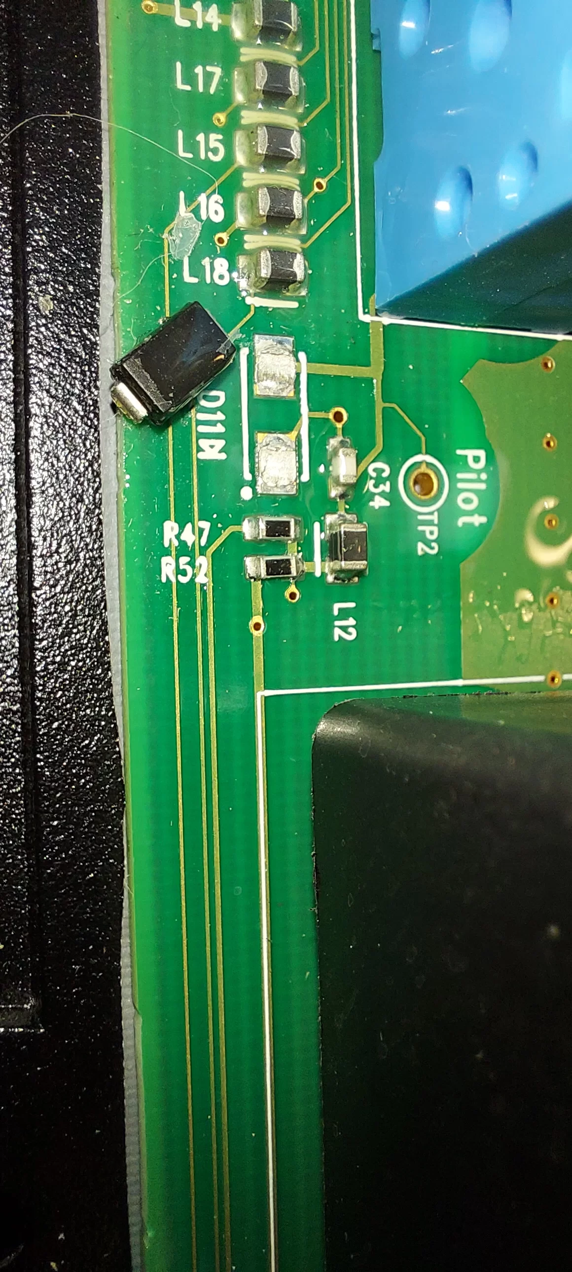

Might was not charging either. Took apart the unit and found a diode had fallen off the circuit board. Looks like the Diode is dead. Anybody have a part number to replace D11?

I am about at the same point as you have shown in your photos....I have the old relay out of the circuit board, but need to clean up the holes. My challenge is that the old solder is not melting. I have the iron cranked up to 480C, but it still won't melt. Am I missing something here? Did ChargePoint use some extreme temperature solder to manufacture these things?
Unless someone has some advice to address this, I think I may be to the point of trying to figure out how to connect the relay to the circuit board with wires instead of soldering directly to the circuit board (and that doesn't seem ideal to me).
