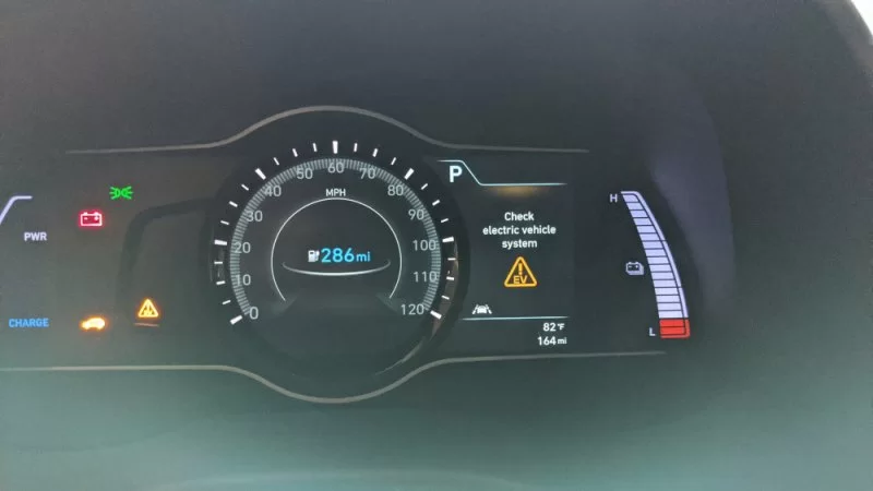

This just happened to me too. 2021 Kona Ultimate, just 164 miles on it. I was going on a longer trip and charged it to 100% with level 2 charger at home. In the morning it refused to move so I had to take my 2004 XC 90 instead. It was a good reminder why I love this Volvo so much :)
Can these codes be cleared with OBDII scanner to get the car moving?

Try disconnecting the negative terminal of the 12V battery (using the 10mm socket wrench) for a few minutes, reconnect and see if that clears it up. If it does you are good to go - software hiccup;)

I tried this without success. When it happened 2 days ago, I disconnected it for just few minutes and re-connected it. Today I left it disconnected for 20 minutes. In both cases this did not fix the issue. I will have it towed to the dealership on Monday.

If you have SoulEVSpy, run a scan to find the voltages of the individual battery cells.

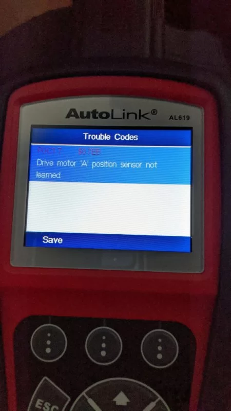

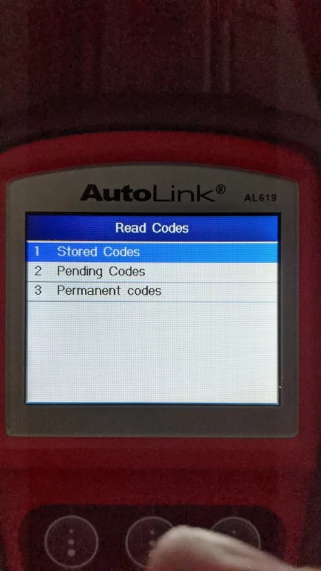

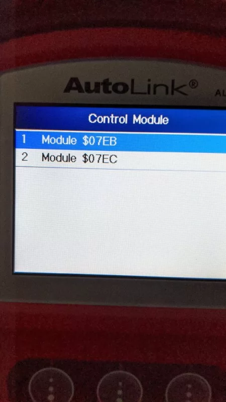

In the meantime I connected an older OBD2 scanner AutoLink AL619. It found a permanent code P0C17 Drive motor 'A' position sensor not learned. I think while I was reading the "Stored Codes" and the "Pending Codes" (which there were none) the error light on the dashboard went away. It found only one permanent code I mentioned above. I tried to erase it and was not able to - it is still there. The car is drivable however.
I wonder if I should still take the car to the dealership. If it drives I am not sure they will do anything.

I would take it in and advise them exactly what originally occurred and any steps you might have taken to resolve it. It sounds like the original error may have cleared when hooking up the incompatible scanner.

That P0C17 resolver code is always present, depending on what kind of scantool you have,
and is unrelated to the battery woes.
