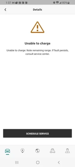

I picked up the car 7/14. First charge with my Juice Box and I blew the circuit at the main fuse box. The Juice Box is on a 50A in the basement for the extension. The circuit that blew is for the whole box that controls the extension.
I put the car on 16A and the last few charges were fine. Last night with 27% remaining I plugged in. About an hour and a half later the circuit blew. I did this a few times, then thinking it was the Juice Box i opened the BMW charger. I put the car on 32A since it was now after midnight, and it blew the circuit. Switched the car to 16A and it blew the circuit and gave me the message to contact the dealer.
At about 1:30 AM with 67% charge I made a service appt for next week. Good thing I have another car because the website offered me a Lyft home. I will dump it at the dealer tomorrow and keep the forum posted.

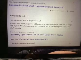

Wading in where my knowledge is limited, but...
At work we have 220 V biomedical equipment that comes supplied with UL-listed, 14 g extension cord. The plug matches that of the MINI charger, so when retiring one of the machines I set aside the extension cord "just in case". Hard to believe that FDA-approved, hospital-located, patient-testing devices wouldn't be up to code. What am I missing?

Your charger L1 provide by SE is 14 gauge at can pull of maximum 10 amps from 120 volts outlet but if you on 220 volts with 50 amps breaker you need 6 AWG wire that’s why you blowing your circle breakers which just should have dedicated line for your charging demands of your SE.Nothing else should be on that circuit just your EV . You must have 8AWG wire there which over heat a system.Advise to you get a good electrician he solve a problem sometimes DIY bad idea if we don’t know what we doing.I wire mine charger with 40 amps breaker bc car can pull only 32 amps usually only 30 amps the most and my run from panel to NEMA 14-50 plug is only 15’ and my Charger have 25’ cord and I never blow my breaker in 6 1/2 years
