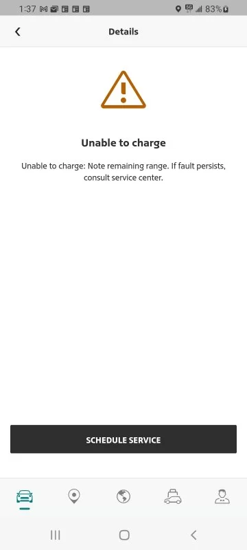

I thought that, but why didnt i have a problem with the same Juice Box on the red SE? Why is it blowing at the main box, not the box for the extension, or the circuit that only the box is on? Initially I thought it was because it was roasting out, and both AC units were running. Last night nothing was on and it blew.
