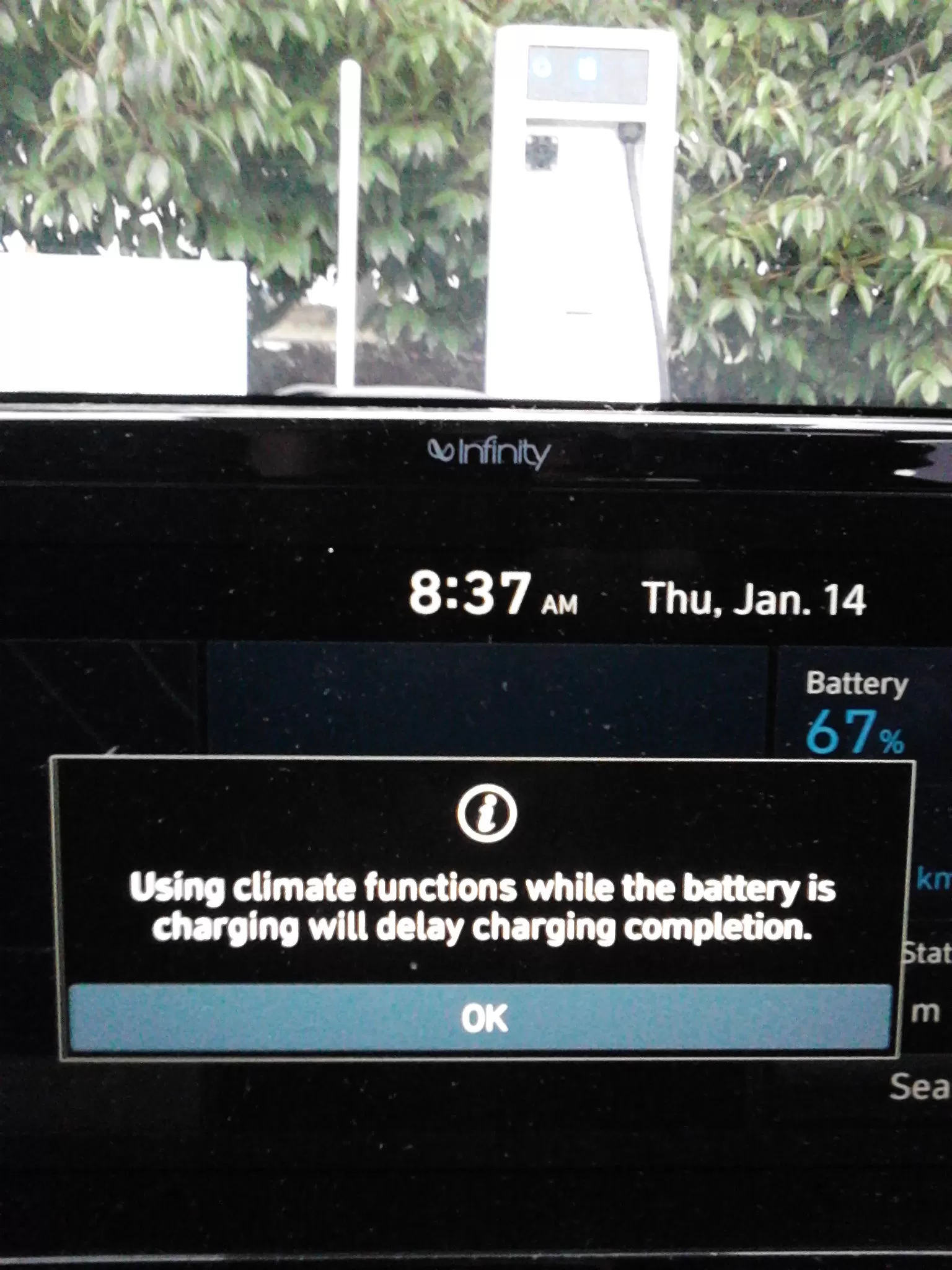

I wonder if the Niro dash displays net or gross power on the dash.. What I mean is that I wonder if it displays the energy going into the battery or like the Kona, the energy received from the charger? For example, if the charger delivers 77kw to the car and the battery cooling is running, the battery only receives 75kw as battery cooling uses 2kw.. I know that the highest that I have seen prior to this video was 77kw on the Kona.. As battery cooling is likely on at that charging speed, the NET power to the battery is likely 75kw when the dash shows 77kw.. The only way to really know is with an OBD2 reader.. I know that when I charge my Kona and battery cooling kicks in (AC+water pumps), the energy received by the battery drops by 2kw.. So, if the dash shows 48kw, the car reports receiving 46kw as 2 kw are used to cool the battery..
It actually says in the dash that heating/cooling will slow charging speed, which underlines your statement that heating/cooling is reducing energy going to the battery.
On the Kona or the Niro or both? I never saw a message on the dash related to that..
In my Kona. If you have the car turned on during charging and turn on the heater/AC it will say that message.
To confirm: one is able to DC high power charge the Kona whilst the car is "on" (not what I call accessory mode and thus draining the 12 volt battery)? Thanks.
Yes, this just tells you that you will charge slower because INTERIOR accessories are slowing down the charging.. However, what I'm talking about is when the car is OFF and charging and battery cooling comes on, the car does NOT tell you that it's reducing charge power due to cooling being active. Dash number of kw received will not drop when battery cooler comes on, yet in Torque Pro you can see that 2 kw less are getting into the battery.
I would NOT recommend to anyone running the AC while charging on DC FAST (Heater is ok). This is NOT due to the power it consumes but due to the FACT that cooling your car while charging WILL REDUCE COOLING OF YOUR BATTERY. Heat is the worst enemy of your battery.. I prefer the battery to be cooled as good as possible to reduce degradation.. I have run comparisons with Torque Pro and running cooling or even the fan when charging DC Fast on a hot day will increase battery temperature while charging.. So, if there is an air conditioned place around where you are charging, it will be better for your car if you wait there for the session to complete instead of sitting in the car with the AC on..
This one:
