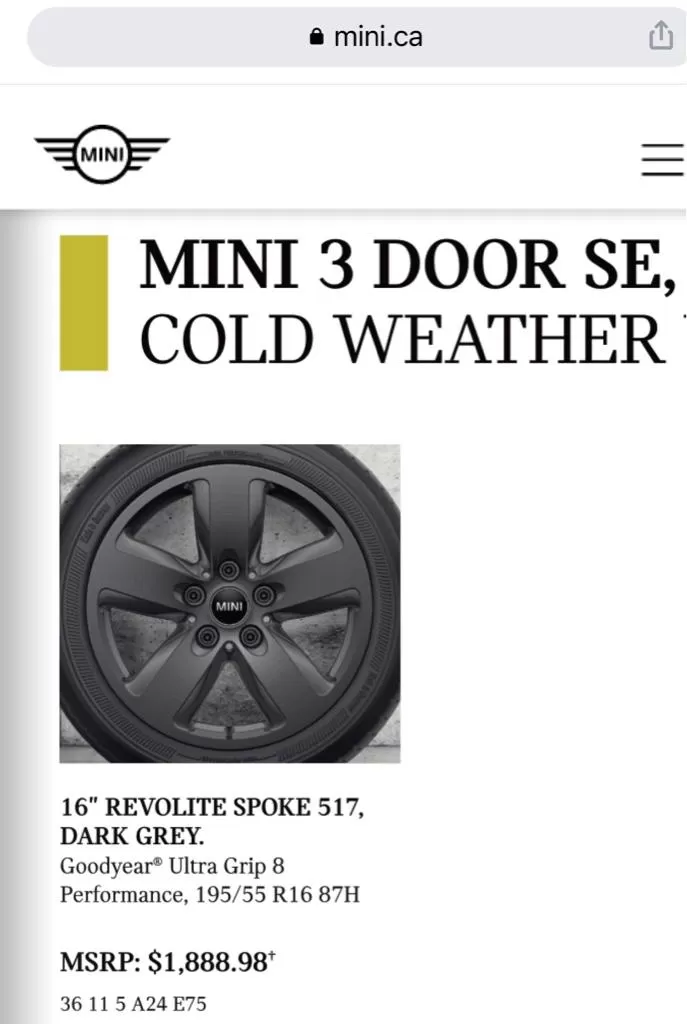

From Mini.ca accessory catalogue.
I was JUST looking at that this morning. I asked the Mini dealership here for an estimate and they didn't say exactly what they'd use. Sadly, if that Goodyear's the one they offer, I read absolutely terrible reviews about their ability to handle ice and slush/wetness. Not good for a city like Montreal which has a lot of both all winter.
Mini offers a few different winter package in different sizes with different styles of wheels, as far as I am aware of, they all come with run flat tires.
