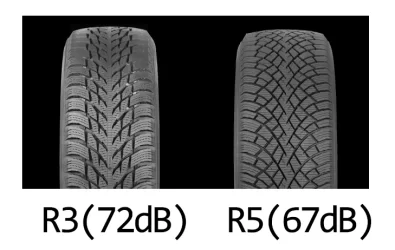

I finally slapped the R5s on today. What do you think? Every year around this time, I have to re-learn that real winter tires are squirmy, and the R5s seem no different. I think they’re a little less sharp than the R3s overall, but are way more beefy. Sad to say, I can’t wait for the first real snow to give them a test (though I really hate snow otherwise).
Well I posted in the wrong thread (oh well) for HVAC but anyways the R5s are quieter than the R3s.

There were plenty of great reviews on the R3 (the previous version) by Tesla owners.
